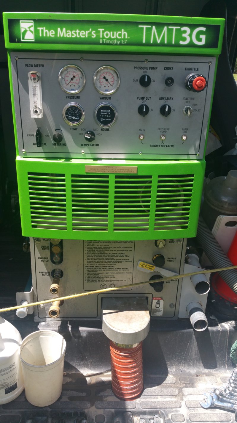

The problems my friend is having are:
1. The water box is over filling. He hooks up directly with a hose. He has turned down the pressure but if it's more then a trickle it over fills and sometimes still over fills.
2. The pressure drops from 2,500 psi to 1,400 when triggered(he does concrete work).
3. The heat is the same on the medium setting as high. I can move the bimba with my hands (unit has around 900 hours)
I'm trying to get him running asap since he is working out of state next week.

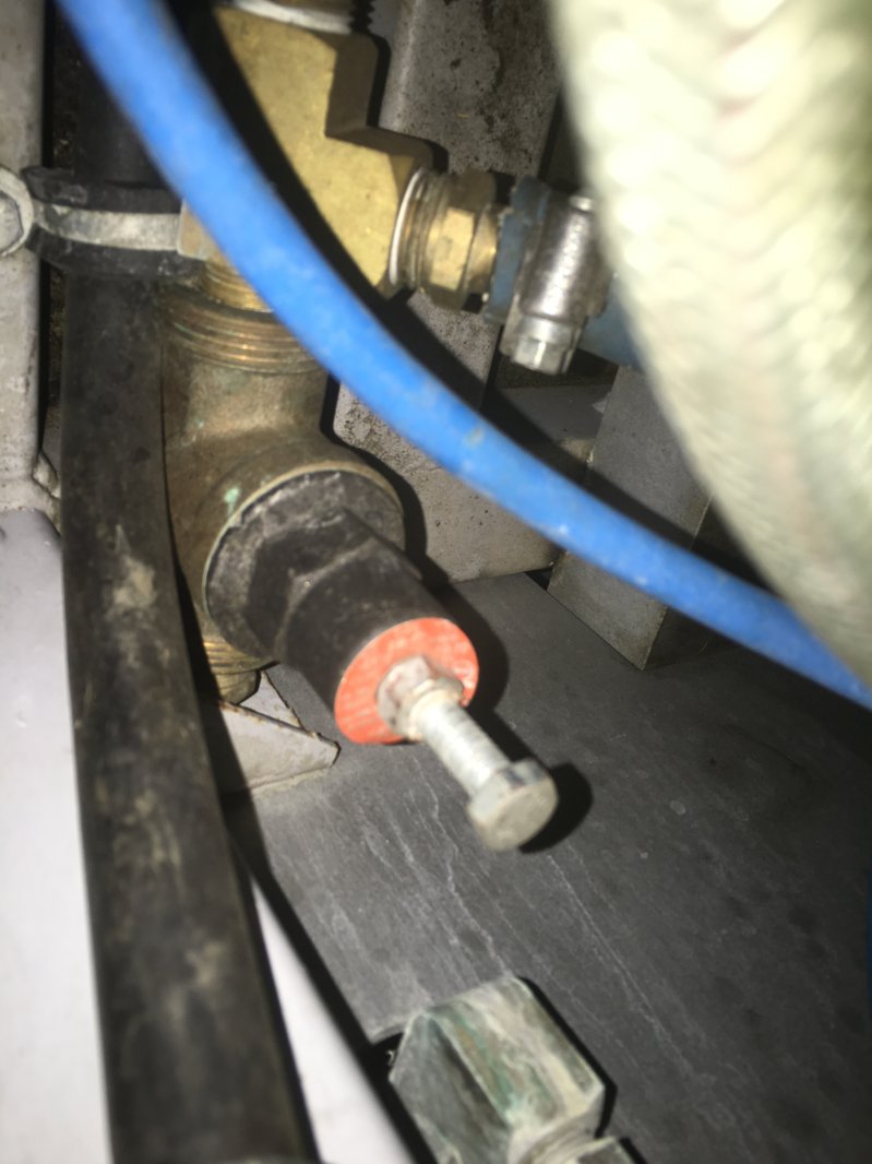

Clean every filter. Especially the filter on the low pressure return to the pump
Lube the stem on the regulator. Make sure the nut is tight.
Make sure that the bypass orifice is not loose. If the orifice is to big or has backed out it will destroy pump volume.

Water box problems might be the cap. It also might be that you have the regulator misadjusted or it is defective.

I'm sure he has never lubed the stem on the regulator. I tried to get it out no luck..:eekk:

The 2500 psi issue has to be a jet/regulator/pump related issues. Check gallons per minute in a bucket test a manufactures published rate. Ensure regulator is not over bypassing, check internals for pitting on that regulator, a regulator that has been working at those high psi levels for sure had wear.

There's a pressure regulator in the front that might need adjusting or a new radiator cap for the water box.
Ps the machine is only spec to go to 1500 psi max.
Right on the front of the pressure regulator it says chem pump 1500 max. There's no bypassing this so if he's cranking it up that high that's bad for the machine and is dangerous.

But ya the pressure regulator on the near where you hook up the water inside the frame can be adjusted it may fix your problem.
