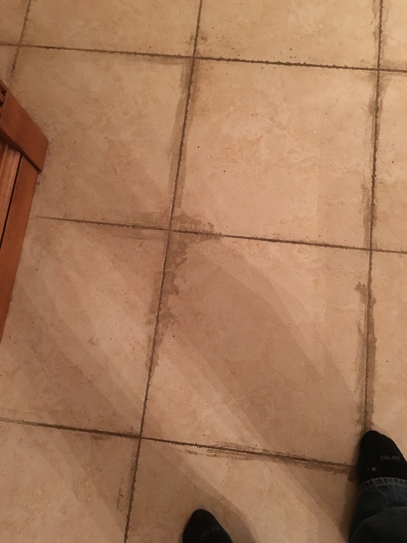

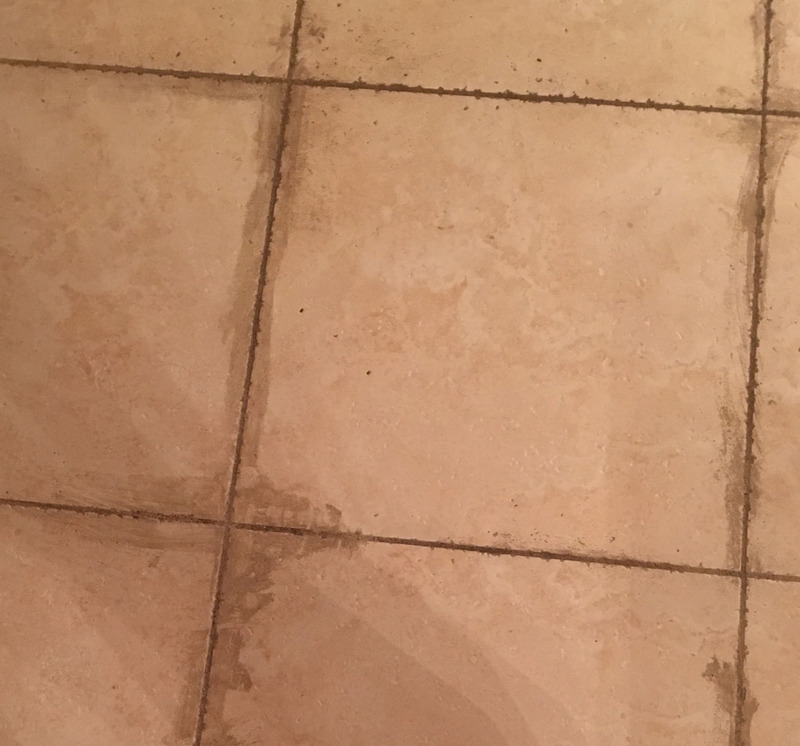

Hoping you guys can give me some advice about this job.
Not sure if I even what to do it if their problem is going to become mine.
This is grout that has been on the tile for about 2 years. It is a higher end rental and the current tenant is moving out. Property owner would like to have it fixed while vacant. About 1,500 square feet.
They are not concerned what the grout lines look like. Just want the grout off the tile.
Simple as black pads and acid?
Any advice would be appreciated. Thanks.

If that is ceramic tile,
Use Interlink's Viper Renew, an acid cleaner. Or any brand of concrete brightener, oxalic acid (Barkeeper's Friend) or phosphoric acid.
Avoid muriatic acid, it will choke the lungs outta you and stain any chrome and stainless in the room.
Apply your stuff by sponge to the grout slop and sip coffee for ten minutes. Use a wood stir stick to help break it up, then a stiff NYLON brush to finish it all off. Rinse the floor when finished, it is easy-peasy.

You should be able to get the majority of it up with a 4" scraper. If you used a black pad, you'll end up with a dull finish and swirls. I am assuming this is travertine, that's what it looks like. You'll need to take it up to a higher finish to make it presentable

I had an apartment complex that had that going on. I would do each one when it was vacant. I had to scrub with a red pad. I used a stripper. It took it off.
