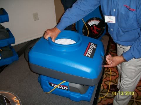

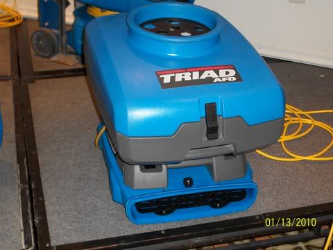

So what about xactimate? Will it be categorized like axial, centrifugal? Will the rental price be enough to warrant the arm, leg and toe that the manufacturer will be asking?
It's supposed to have an air scrubber attachment too. Iseeru

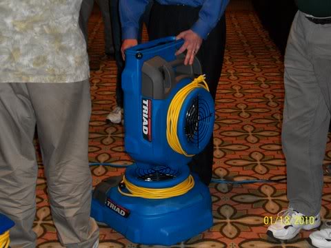

I haven't tested the unit but I can say we use the same blade design in the HEPA 500 and many other products. We first started using this blade design in 2002 on the Air Wolf so we know the fan technology well. As for the filter capacity there are certification tests that will determine its efficiency however you must have a specific about of filter service space calculated against air flow to achieve HEPA performance. It appears they have a damper in the inlet to control airflow but I suspect this is for balancing a negative air environment not to reduce overall airflow to meet HEPA.
Time will tell of course but since it takes 3 amps of electricity using this type of backward inclined fan design to produce a 500 CFM certified HEPA filter (HEPA 500) and they are claiming 1.48 (why not 1.5?) seems pretty unlikely to me.

I can not check cfm. but i can check amps, and that is the first clue.
And I never let that engineering degree stop me from shaking up the industry a little before. :wink:
Have you got any idea just how stoopit someone is gonna look when that ameter doesn't read 1.49 running amps?

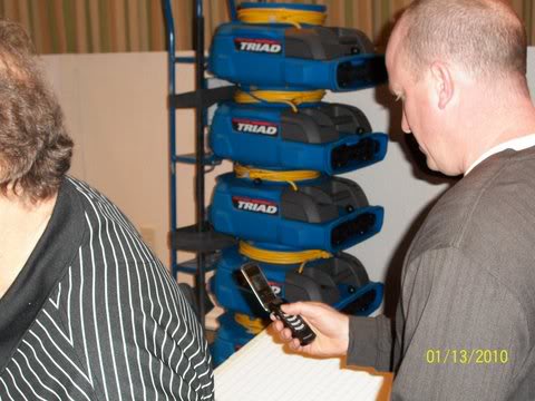

LOL No Richard they are not selling Dollys. That is a standard Furniture Dolly they used to show how many you can carry at one time.

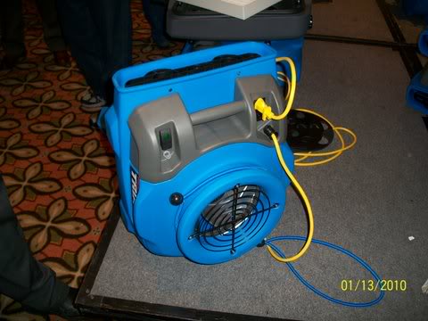

That airmover looks like it would be easy to carry... I like that.
I'd pay at least 175 each for em. Unless they are crazy amazing I don't see anyone paying almost 400 for those.
