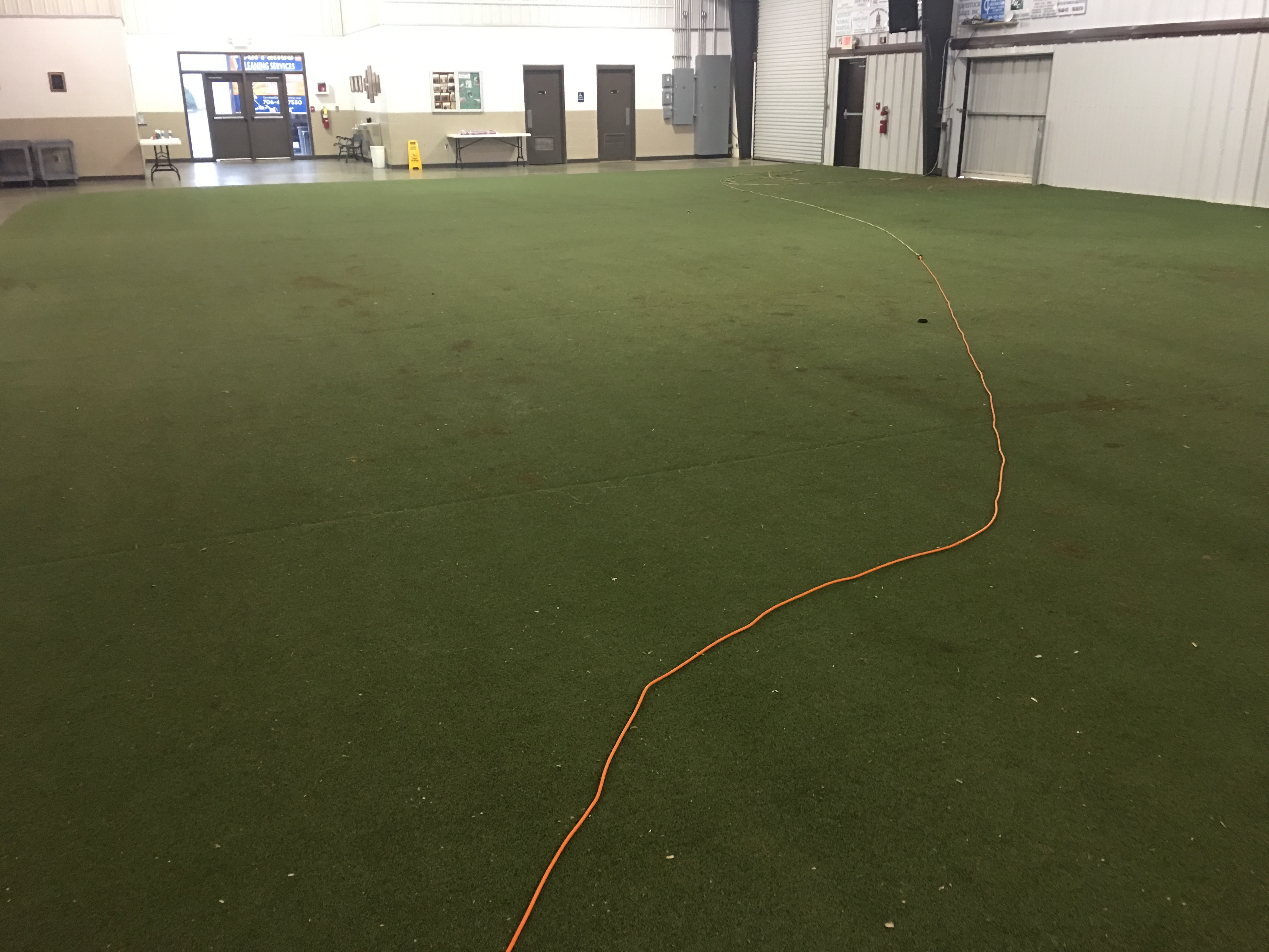

Is there a prespray with the same ph as the acid rinse that's made for soil removal? Here is my thoughts:
I just finished cleaning some AstroTurf that farm animals walk on for shows For the 3rd time.
Here's my process I used:
-prevac
-soak in acid
-HWE
-spray enzymes
Next Day: wasn't needed but I went back
-sprayed more enzymes
The soil isn't normal traffic oils attaching to the fibers. It's just poop, urine, and loose dirt. My main dilemma was the urine, because it's so much from 300 farm animals. Prevacumming got the most of the soil, but I needed that little oomf to get the remainder. My main problem was the urine of course, so I soaked it with acid. My time and saving chemicals was what I was fighting, because it was a 6hr job, and a huge square footage. I could've just used a whole case of enzymes, or acid, dwell, then prespray normal traffic cleaner, and HWE, but I would've lost 2hrs of time plus spent extra money on chems.
So is there an acid based prespray with a ph of around 3 to break down urine salts AND has surfactants in it to suspend the remaining soil in the carpet? Or is there a neutral surfactant I can add to my acid rinse? I think that would save us so much time for the carpets that don't need an alkaline treatment.

My reason exactly for this thread. The job isn't profitable enough to add over $200 worth of chemicals on it. And keep in mind, this isn't like the average pet urine job in a house with normal carpet where my wand has a good connection.
Astroturf is different than normal carpet when it comes to the wand getting a good vacuum connection. It feels like I'm sucking hardly any water up, compared to the normal poly we clean over. So I need to use a method that has the ability to break down the major amount of urine salts and soil at the same time, unlike our residential jobs, where we have time to do another room, or clean upholstery while it dwells...the whole place is urine infested, so I can't just go out to the truck and waste an 1-2hours of my time.
And, unlike you, who can just go out to the van to waste an hour of your time...I don't like to waste over an hour on a job. Time is money. Buying extra cases of chemicals and letting it "eat bacteria" for an hour or more is a waste of time and money. Just get the proper acid application to quickly break it down, rinse it out, and spray a good coat of enzymes AFTER it's been cleaned to give it all the time needed at NO EXTRA COST.

I used Harvard's rinse on this one, so I'm not sure if it has any surfactants in it. @Mark Saiger might know. My main concern on this one is preventing return of urine odor. It looked great every time I cleaned it. I think it might look a little better if I had more surfactants added.

How many times have you cleaned something like this? I'm just brainstorming, trying to find an easier, quicker and effective way to get all this pig piss flushed out.
