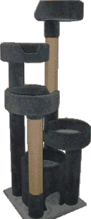

A friend is letting me take this huge 4 year
old 2x2x6' cat tree off her hands this Sunday.
She was trying to donate it, but the shelter
could not find a volunteer to pick 120lbs up.
It's VERY well made, of non-loop carpet
heavy laminate, firm wood screws, Sisal.
The manufacturer gave me some ideas on
how to partially dissemble and clean it, to
ensure my cats don't inherit any germs,
but I would still enjoy your input here.
