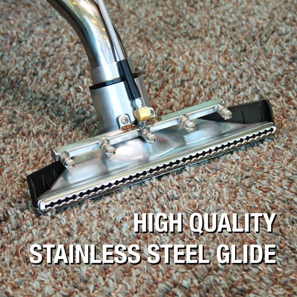

do you get much overspray dribbles at the wand ends?
Generally only noticed on loop pile and CGD
if so, you might try a slight angle on outside jets
That is the issue. I will give that a shot but I was worried about streaking. I'll just have to check as I go.
47,988
Prattville, Alabama
Oh, you didn't say that was the issue. You're screwed on most wands. Angling the outside jets helps some.
The only wand I've ever owned that could be adjusted effectively enough to solve overspray issues is the DevPro, but I have to angle the outside jets even on it!
Yeah sorry should have been more specific on the thread. Good to know I'm not the only one to experiencing this.
30,540
many (most?) don't notice it or pay attention to it .
you don't see it on cut piles, only low and tight loop.
It aggravated the schiite out of me too.
what I discovered, it's not so much the jet over spraying the wand, but splash on the wand side wing dribbling off a stream trail .
to confirm that, hold your wand off the deck and trigger it.
You'll most likely notice drips and dribble stream off the side wings
experiment with jet twist angles
Both directions (outside of jet angled toward wand lips and away)
see which way minimizes the wing drip/dribble

They should be angled about 5 degrees or so.
