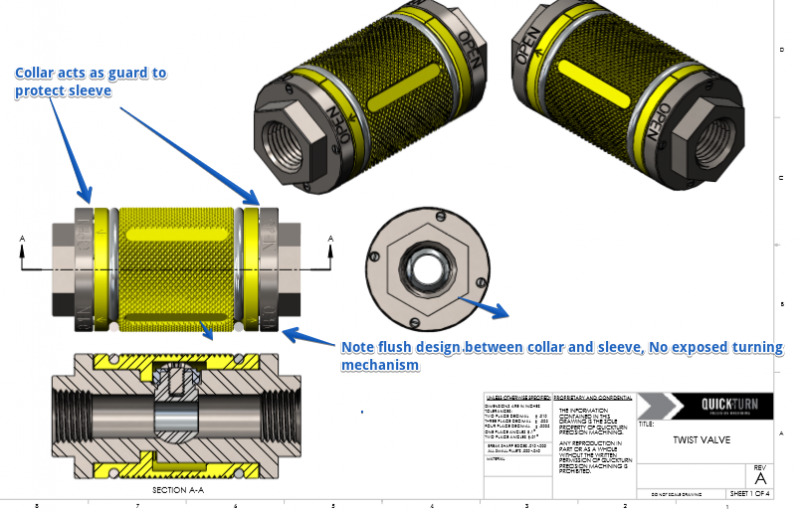

Take a look at something great we developed. All details are in slides below..

By changing gear ratio's manufactures can obtain desired open/close ratio..We imagine them using the 22.5 or 45 ratio's for optimum performance. Also the larger gear ratio's increase the overall all size of the valve due to the larger gears needed...

What are the chances of it opening and closing by itself as it moves along the carpet. How easy is it to visually check if it is open or closed?
The valve has built in positive stop mechanism. The pic above shows the commercial version using spring plungers but the residential uses bump stops. There are positive indicators on the sleeve along with arrow markings and on/off text on the guard collar

how about coloring the on/off settings green and red for us old fogies who need reading glasses. green dot/red dot.
Absolutely it's not shown it the drawings but we have 4 new ones being built for a video shoot. We had planed on doing an "O" and "C" on the color. There are indicator arrows on the sleeve (small arrows) if you look at the Knurling (hatch pattern) on the sleeve you'll see long flat spots. Those are also indicators...I fully understand the reading glasses..LOL
