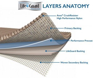

There's a plastic layer above the backing. < Wrong.
This picture shows the plastic is below the primary backing, so spills will soak into that layer of latex.
Still probably easier to deal with than pad and flooring impacted by urine.
