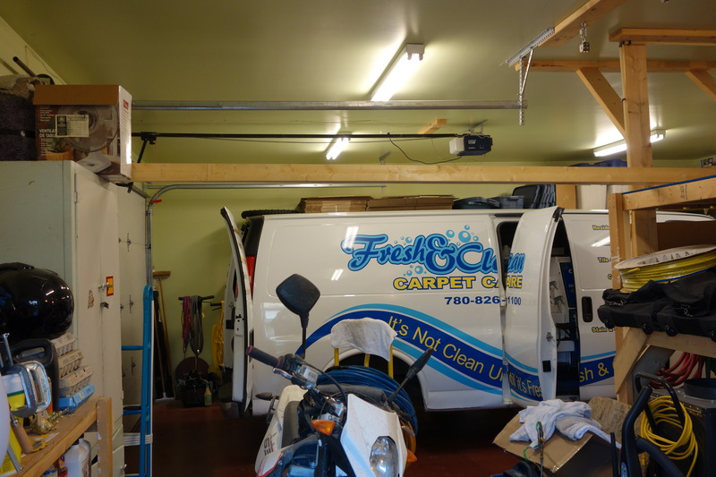

I've always struggled with finding space to dry area rugs. Had a good rack made out of 2x4's (think it was modeled from a picture Ken Snow posted years ago) but after a period needed the space for storage and tore the rack down. Recently had a customer drop off a fine "Persian rug" (was a pos synthetic) and needed to come up with a way to dry it. Lucked out and found a spot where 12' 2x4's would span between a shelving unit and a tool cabinet with 9' of clear span.
Have a look around your shop, maybe the space is there.

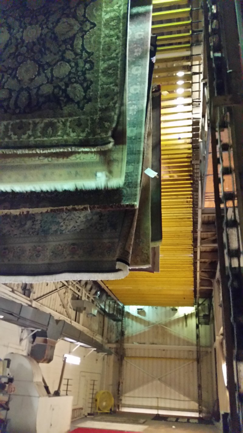

My rug drying racks are very economical .when I built my shop I had the trusses engineered o hold the extra weight of the rugs and spread the weight out over the different trussses with four by sixes. the poles are made from bci's skined with quarter inch plywood for sheer. I paid about five or six hundred bucks for a 110 winch to raise and lower each drying rack and each one is 16 feet long. Not a big operation but I can wash as many rugs as we can physically do with a small operation and dry them in one day. I also use wire rope for the rigging. We have 12 foot walls in the shop plus scissor trusses so the height is approximately 20 feet so we can walk under the rugs while they're drying.

Nice. I make do with 10 ft ceilings and 5 -12ft long racks. I don't do anything larger than a 10 x 14 normally.
