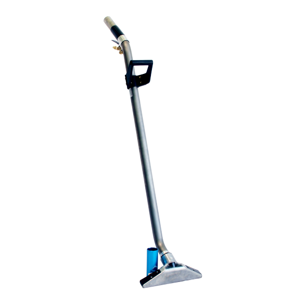

Well a big thanks to Mytee for another inovative product. The new Bentley titanium is really sweet. We have been using them for about three weeks now and every one loves them.
Pros. Swivel, no glide to replace, lightweight, good flow and the Jets are fixed. Yes solid jets lol.
Con. Not sure how long the plastic splash guards will hold up.
Overall good wand a worth every penny.

We have several of the Bentley 14" single slot wands out . . .
with favorable cleaning reports.
We have not replaced any splash shields.
Waiting to try the double-slot Bentley Plus wand
in Las Vegas in a few days

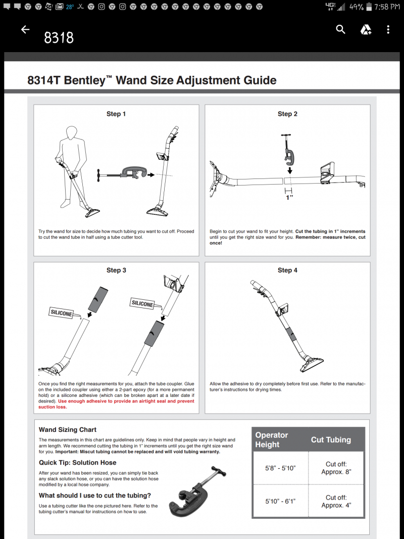

Are u going to use the reducer tube?
We have not used one yet. Out of six guys only one guy is still using a short carbon fiber wand. I am not too sure how the reducer is going to work. I am hesitant in cutting a wand.
