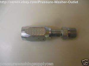

PS: Our guys used to carry screw on field-repair fittings like the one below. If you cut the hose end evenly and the interior of the hose isn't failing, these will last as long as a crimped fitting.

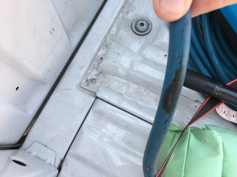

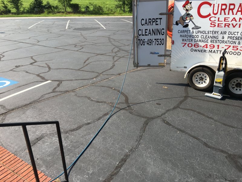

Will Parker hoses prevent this?
You guys are crazy if you think titans can only produce 175F from the MF a few years ago. 230F makes my hoses do this on parking lots. And my continental junk gets it first
