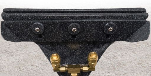

We have a new Rotomolded 12" wand with two #11003 Teejets that has been getting a lot of attention.
The streamlined head has very good AirFlow, is very light, and adjusts to the height of the operator.
Good downforce extraction, from more effective sealing.
Works on Carpet or Tile & Grout.
One PowerClean TM customer raves that it blows away his more expensive Evolution wand.
$289 . . . . As always, we do recommend Mytee's assist handle (19.95).
