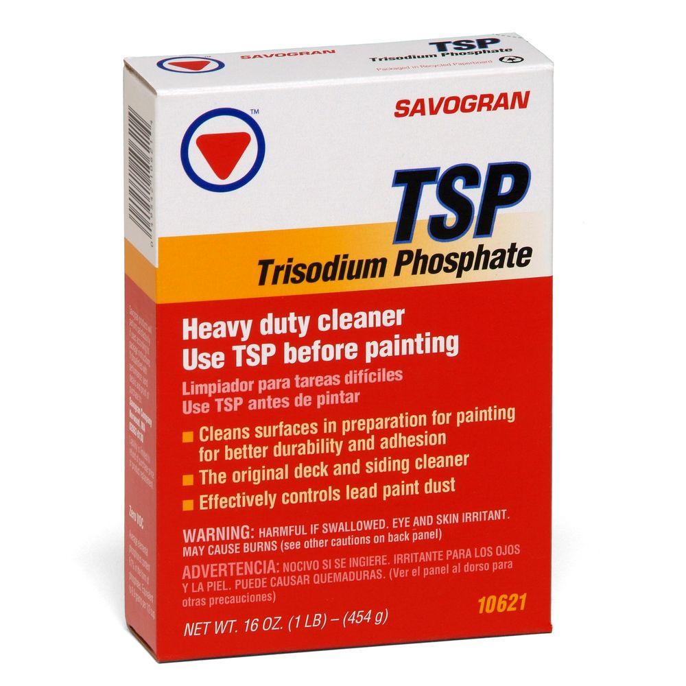

Heart of Dixie
SPIC & Span?
You know what we call that in our company?
Honkydust!
By the way, there is a powdered product called “Soilex” which cleans better than TSP and does not require rinsing. Great prep for painting, presumably would work for a smoker’s house.
