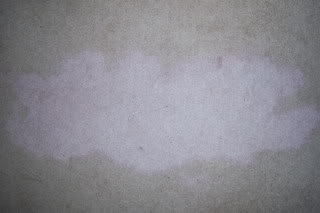

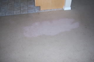

I've been given the "see what you can do" greenlight for this rental. They were planning on replacing, so I'm free to experiment.
Is this area too big for a crayon job?
it is about 1 foot by 3 feet bleach area. The carpet is beige. there is no extra carpet for a donor.
How would you tackle this, what color would you use, ect.
Idiot proof this as much as possible for me please.
Thanks

Charles, just a couple of ideas.
Acid dying, in spray bottles, but only if you have plenty of experience working with primaries.
Or cut out a strip of the carpet that includes the bleached area, and going to the tiles, and the width to the left? hand wall?
Put a totally different piece of carpet in as a feature.

Charles, it is pretty large for crayons but it can be done.
Hard to tell what color it bleached to, from your pics but if it has gone from beige to yellow - start with a light brushing of pink crayon in a 3 inch square area near one edge - like that small bit sticking out on the right hand side. If it looks good, keep going and then try either a very light blue or green ( blue - yellow) or gray ( in which blue is the dominant color ) crayon. If it looks worse - wipe it off with some iso-propyl alcohol and try something different.

You're right Tony, it is hard to tell from a photo.
But I think this one is the other way, it's lost mostly yellow, leaving a violet colouring.
