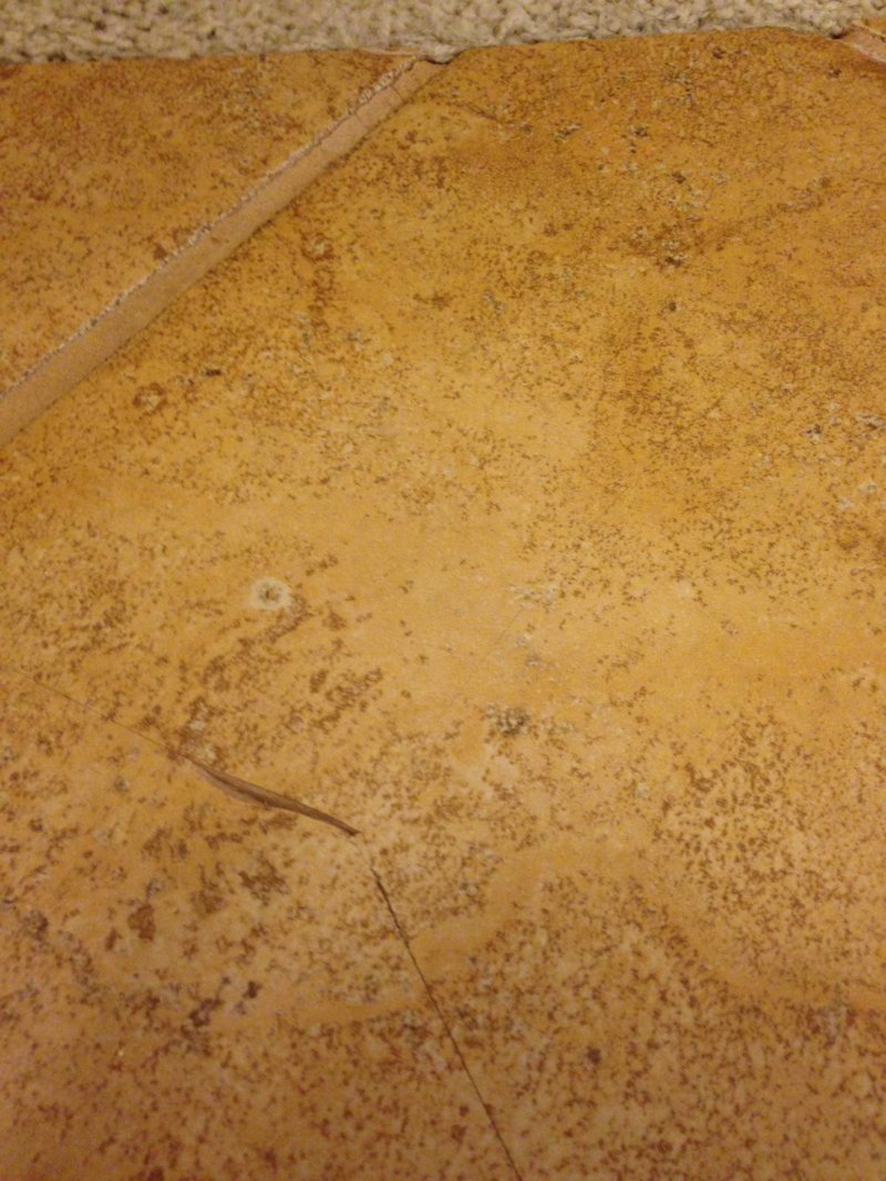

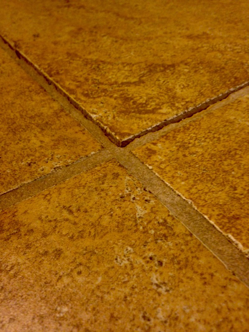

If this was cause by something falling on it, then it's because there is not a proper bond underneath. The closeup of the corner of the tile looks lifted, like it was raised over time from settling of the house. The grout is cracked immediately adjacent to the tile. So you could have caused it, but ultimately the real problem is likely the install.

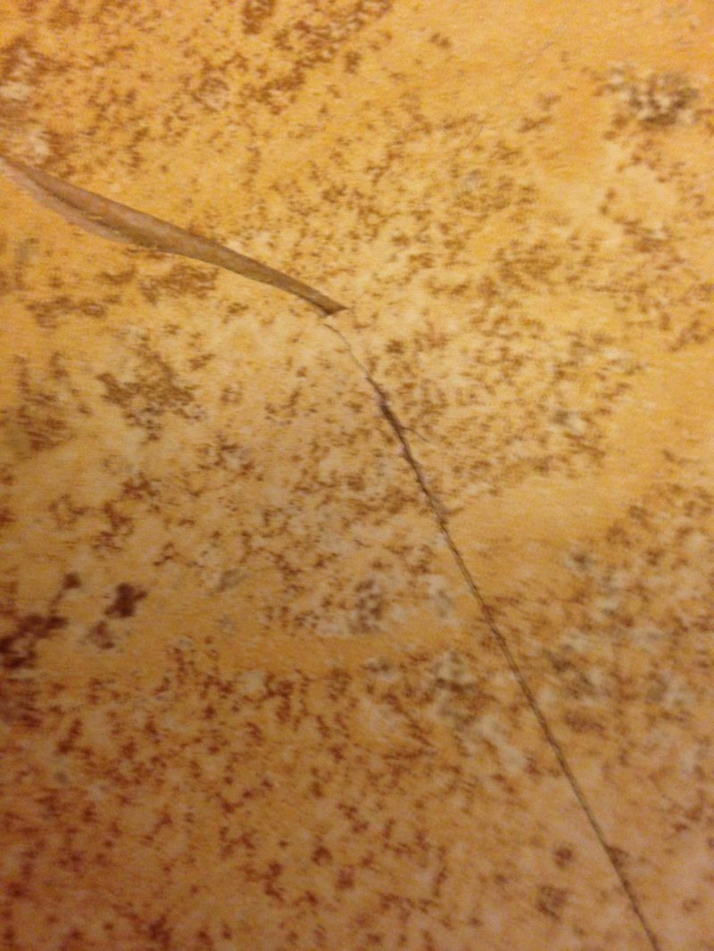

This tile had to have moved for it to break like that. When you drop something on a tile that has a solid bond, it doesn't chip like that, it will leave a roundish divot, not a wedge shaped void. Also, where the crack is very thin, there are very VERY tiny chips along the edge of it. That is from the tile buckling inwards and the edges of the crack rubbing against each other. It only does this if the tile has enough give, or space under it to move that much.
They could have also very well caused this after you left without knowing it. Usually, when you break a tile like this, the sound is very noticeable.
