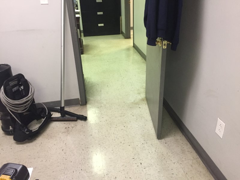

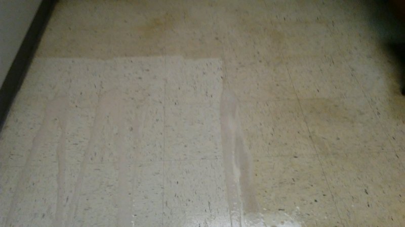

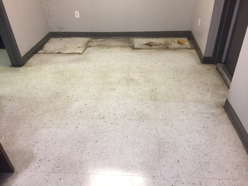

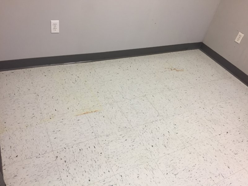

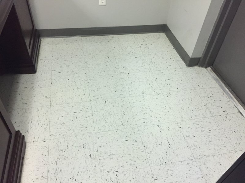

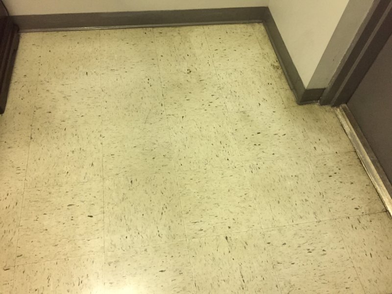

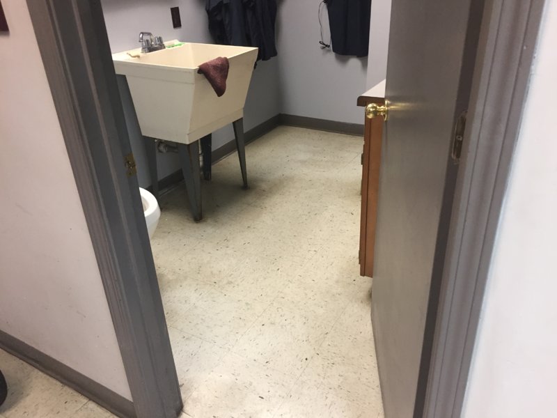

Once in a while, you have to shake your head. This office is the business place of one of our residential customers. The guy who 'maintains' their floors apparently thinks that waxing over dirt will make it shiny.

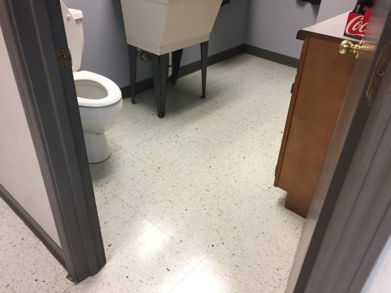

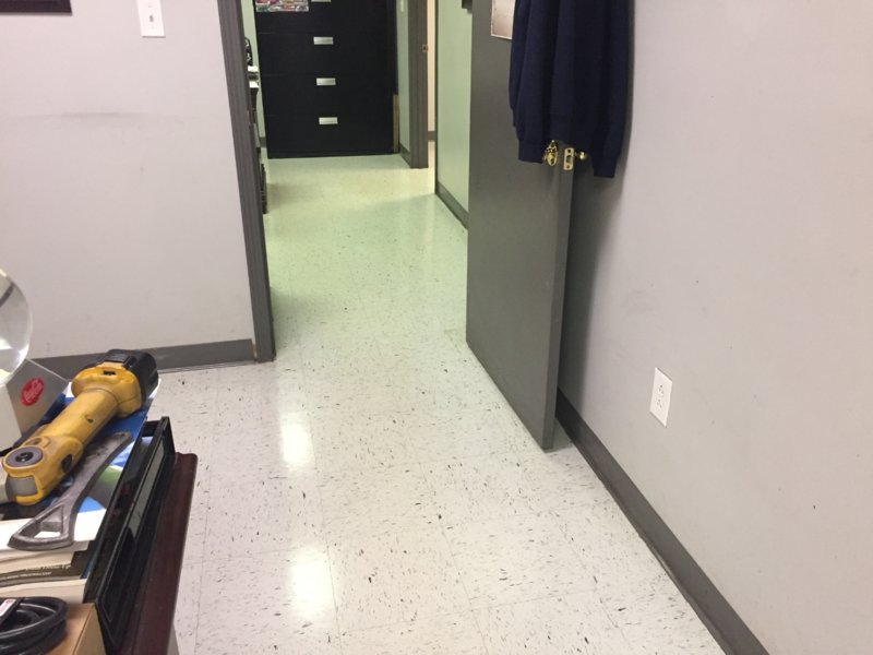

It took four of us twelve hours, working through the night. Gang, you should have seen the elves scraping and working the unbelievable caked, nasty crud. They were on their hands and knees almost all night. I was finally able to put down several coats with only 1/2 hour to spare before the owner arrived. Could not even burnish it. But perhaps the next time.
The pictures barely do it justice.

Nice work. I retired from VCT. I guess it was just a bad experience, but it was enough to make me hate doing it. The floor had not been stripped in 15 years. I worked 19 hours on that damn floor. Never again.

You rescue a floor like that and you've got a customer for life!!!!
Hopefully a couple times a year now that they know what you're capable of.

Using the right techniques with the right chems along with right equipment the job will go faster, safer and yield great results.
Btw, most finishes these days don't appreciate a burnishing untill fully cured, we wait at least a few days if not a week to burnish.
Just think any small abrasive caught in the buffing pad will mare that floor really bad since it is still very soft= Not worth the risk and since not fully cured the result yielded from the burnish would not be noticeable or worth the time.
Not all finishes are like this and there are a few that recommend a burnish but I don't use those finishes for that reason.
