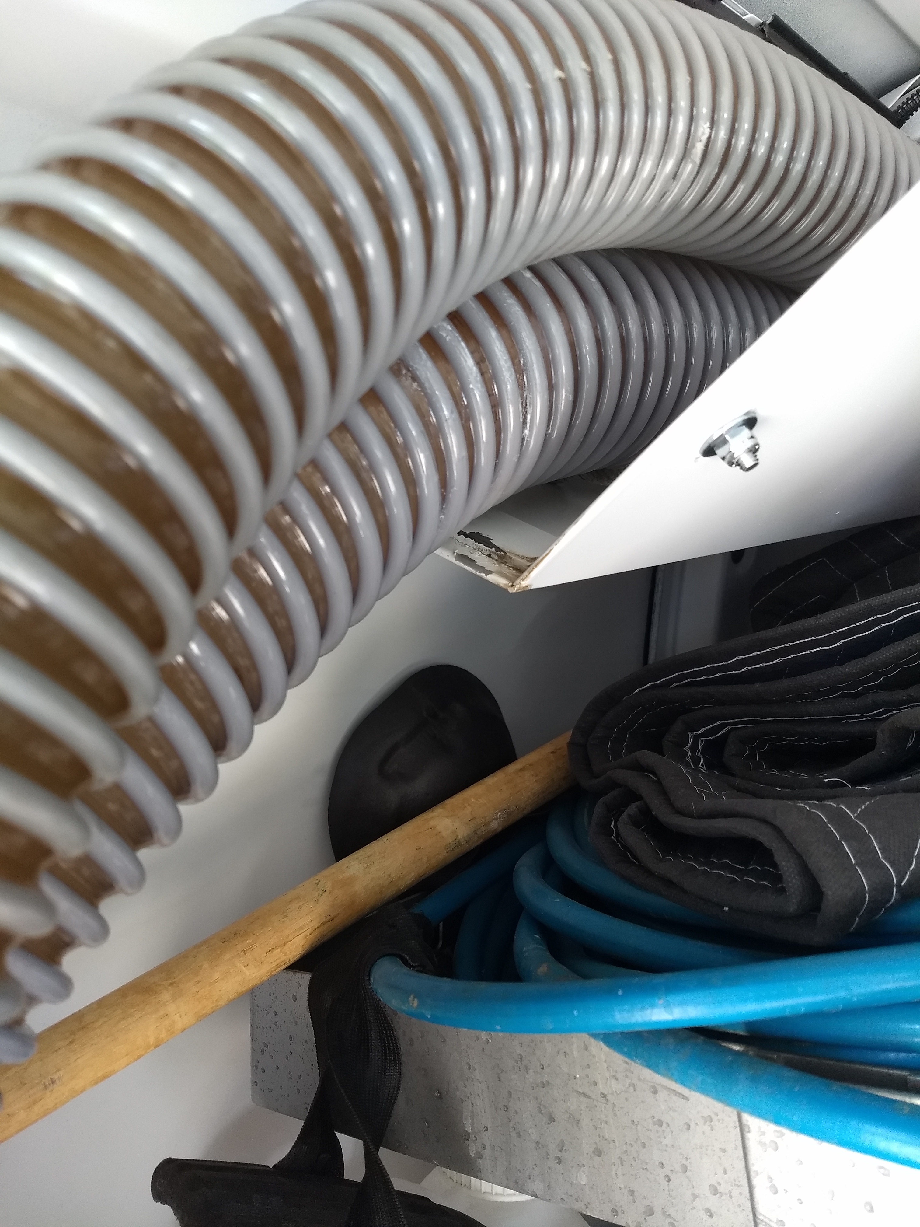

Jun 27, 2018 #1 Lyman Supportive Member Joined May 19, 2007 Messages 1,759 Location Johnstown new york Name Lyman The three inch hose from the filter box to the top of recover tank wore thru on the white shelf that holds the hose up. 14 months old. Only figured it out my hearing a faint air leak. Wore a 1 inch slit in hose. Reactions: Bob Pruitt and Steve Lawrence

Jun 27, 2018 #3 Steve Lawrence Member Joined Oct 10, 2006 Messages 3,739 Location Ann Arbor Name Steve Lawrence I think I see it. Thanks for the heads-up.
