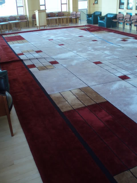

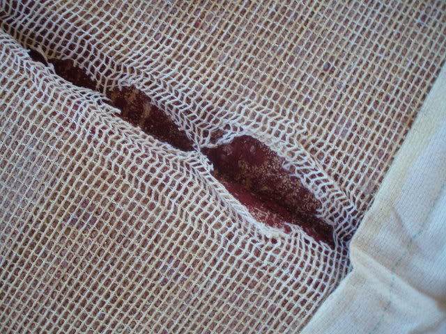

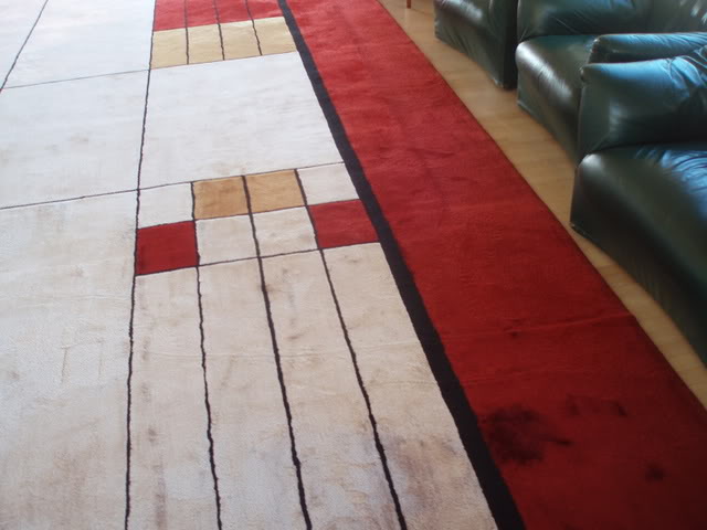

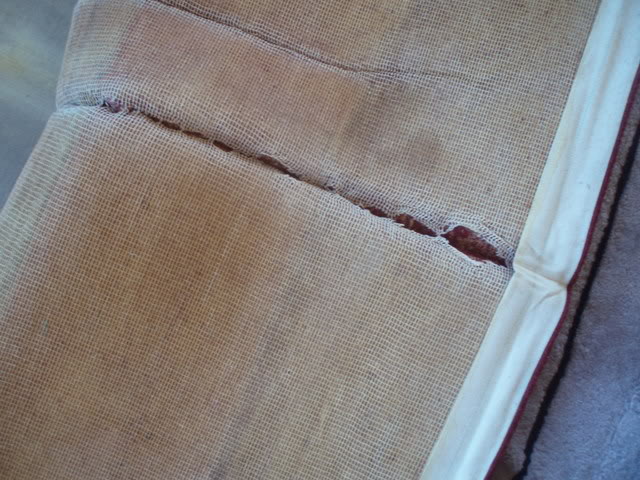

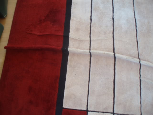

30 year old wool. All pieced together. Sees lots of use through out the average day. Chairs and tables getting hauled across it daily being rearranged. The damage to the backing was doe when the last company rolled this beast up and dropped it down 3 flights of stairs.
This is the 3rd time we've cleaned it on location.
I've put a sheet of particle board under it and stapled it down but as the rug gets used, the wrinkles come back. (in the same place of course)Usually takes a month or so.
Rug is not fixed to the floor in any way and is on top of so Nomuv.
How would you go about fixing this?
I have some ideas but would like to hear those of the Tool Room Pros.
After I stretched it out and tacked around the wrinkles.

I think that the problem here is that there is not enough dimensional stability in the backing for the size of this rug.
So my guess would be to latex on an extra layer of backing material like monk's cloth.

Some serious damage to the backing as you can see and so much slack that I could cut out the damaged area and stretch it back together before applying a new backing.

Bet you could make a few simple stretchers out of 1x4 boards, tack strip and allthread. Stretch out from backside and repair in sections by glueing on new backing in affective areas.

You would have to steam out the wrinkles carefully ,or block it out on a floor . I would latex and reinforce it with a Scrim tape 6 inches wide. Let dry over night. Also what you do if they dont mind . Assuming this is a wood floor you can put down some tackless and make a permanant frame. I see you wrote they do alot of moving things around. I had a 3/4 yd wilton rug do the same thing. Who ever sewed it put to much tension creating puckering that eventually turns into wrinkles. Permantly block it after a couple attempts . No problem since.

Winner! The backing is broken down enough over the entire rug that fixing just the wrinkled section will invite the adjacent backing to fail. Tacking it out won't help as under tension the weakened backing will continue to fail.
I'd use Jute to give it a heavier backing, and jute sticks to latex better than Monk's cloth. Well, at least the current version of Monk's cloth that has a lot of polyester in it.
Roll the rug up, drag the roll around 180 degrees and pull it back out upside down. Usually you'll have to put tension end to end to get the area of broken backing to lay flat. Sometimes this is as simple as having two guys pull on opposite ends, sometimes you'll have to figure out a way to tension. I've used two senior carpet stretchers assembled into one with a head on each end. If it doesn't want to stay stretched, you could try "massaging" the back of the carpet with hot water using an RX-20 while the carpet is under tension. We were successful fixing a 40 x 90 hand-tufted in a hotel lobby this way. There should be no need to cut the wrinkled areas.
Once the wrinkled areas are flat, starting in one corner, spread a good quality latex (Parabond) over an area 4 feet across the width of one end of the rug wide by three or four feet down the length. (3 or 4 foot wide fabric is easier to work with than wider widths, and easier to find). Spread the latex just thick enough for it to get a grip on the backing fabric - it shouldn't be in puddles. Set the backing fabric into the latex and let this first section set up until the fabric is well stuck. Keep working down the length of the rug.
Lap your next course over the previous by an inch or two and do it again until the rug is completely covered. Leave it in place to dry overnight and then roll it up and turn it face up. Other than making it a double-stick installation, the choice is between doing this or replacing the rug.
NOTE: When stretching, pay attention to the straight lines of this carpet and try to keep them straight. If the ends are irregular when finished, trim them and finish the cut edges with latex and hand bind.
Latex and backing: $7.50 PSF. Hand-binding: $10 per foot.

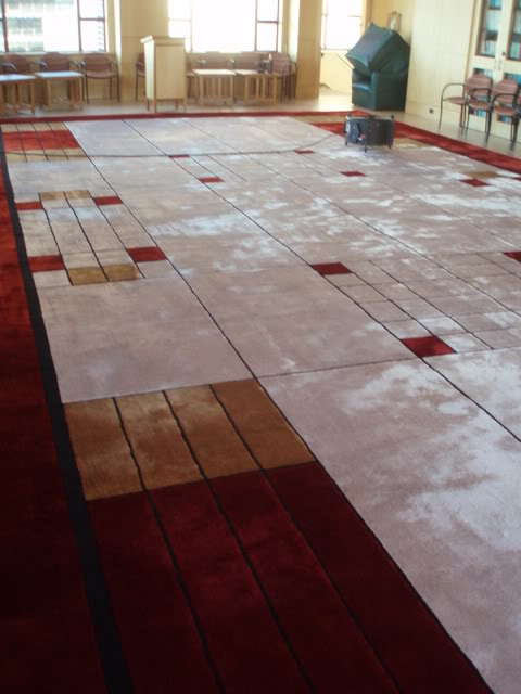

We rolled the whole thing up the first time we cleaned it (and the pad) to vacuum up the vast amounts of dust underneath..

That rug looks to be at least 60x20 feet. So if this turns out to be a $9,000 job or more, make sure you video the whole operation. I'll bet there are a lot more like that in the Bay area and this would be great promotional material.

The goal is to get the rug flat and get it to stay flat. Very quickly those wrinkles will show wear from people dragging their feet over the high areas.
If it isn't possible to stretch the wrinkles out and get the center of the rug to stretch the same amount, you'll end up with a wavy end. A straightedge or chalkline can be used to mark and cut the ends and the cut ends can be given a finished look by wrapping them with binding tape.

The rug is not hand knotted or woven, but hand-tufted, so the Oriental rug people would be unlikely to have a clue as to how to fix it. I'm also skeptical of the $2 clean, repair and guarantee guy. Since Mondrian was dead long before this was made I doubt there is any artistic provenance to worry about. The value of the rug comes from the initial cost and the cost to replace. A seller would find a limited market for a very specialized, very large tufted rug, and tufted rugs don't go up in value with age.

Harry, The stretch is the key. If the rug is flat, no worries about locking in a wrinkle. The only reason I would not want to do the scrim tape is that often a rug in this condition will just end up with weak areas that turn into bumps on each side of the scrim repair. Scrim enough and you might as well put on a full backing.
