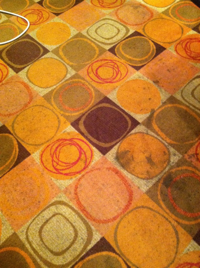

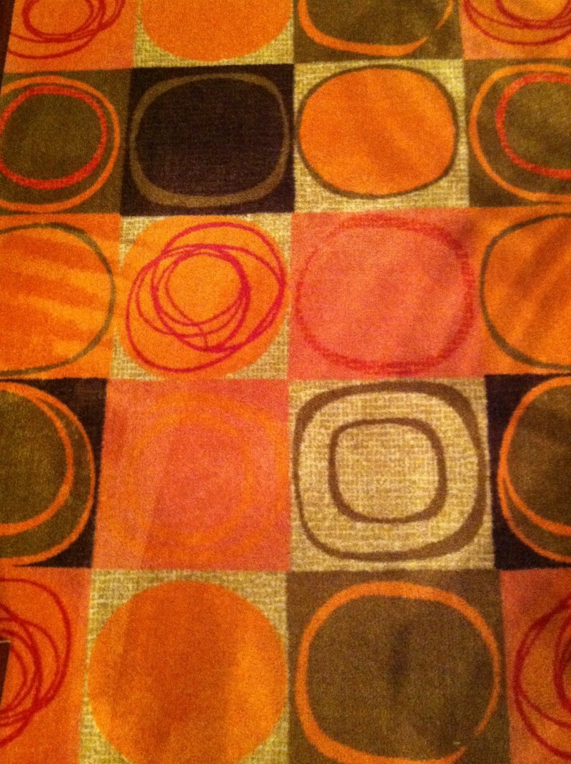

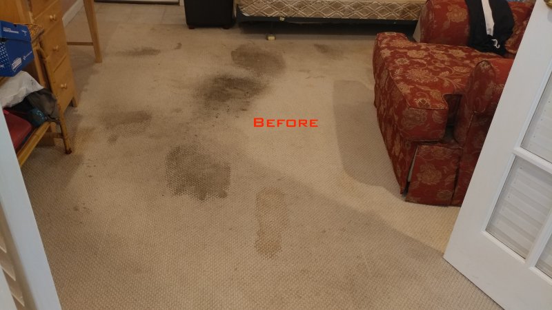

bayberry after 2.jpg I use encap products all the time, vacaway, bonnet pro and releasit are all good products, I put solution in my 175 rotary which has a solution tank, and use the carpet brush, can cover a lot of area fast, then just a fresh water rinse with my LTD5 or just run the wand, or if you have an op machine follow up with cotton bonnets, easy pezee this is one i did that way last week
