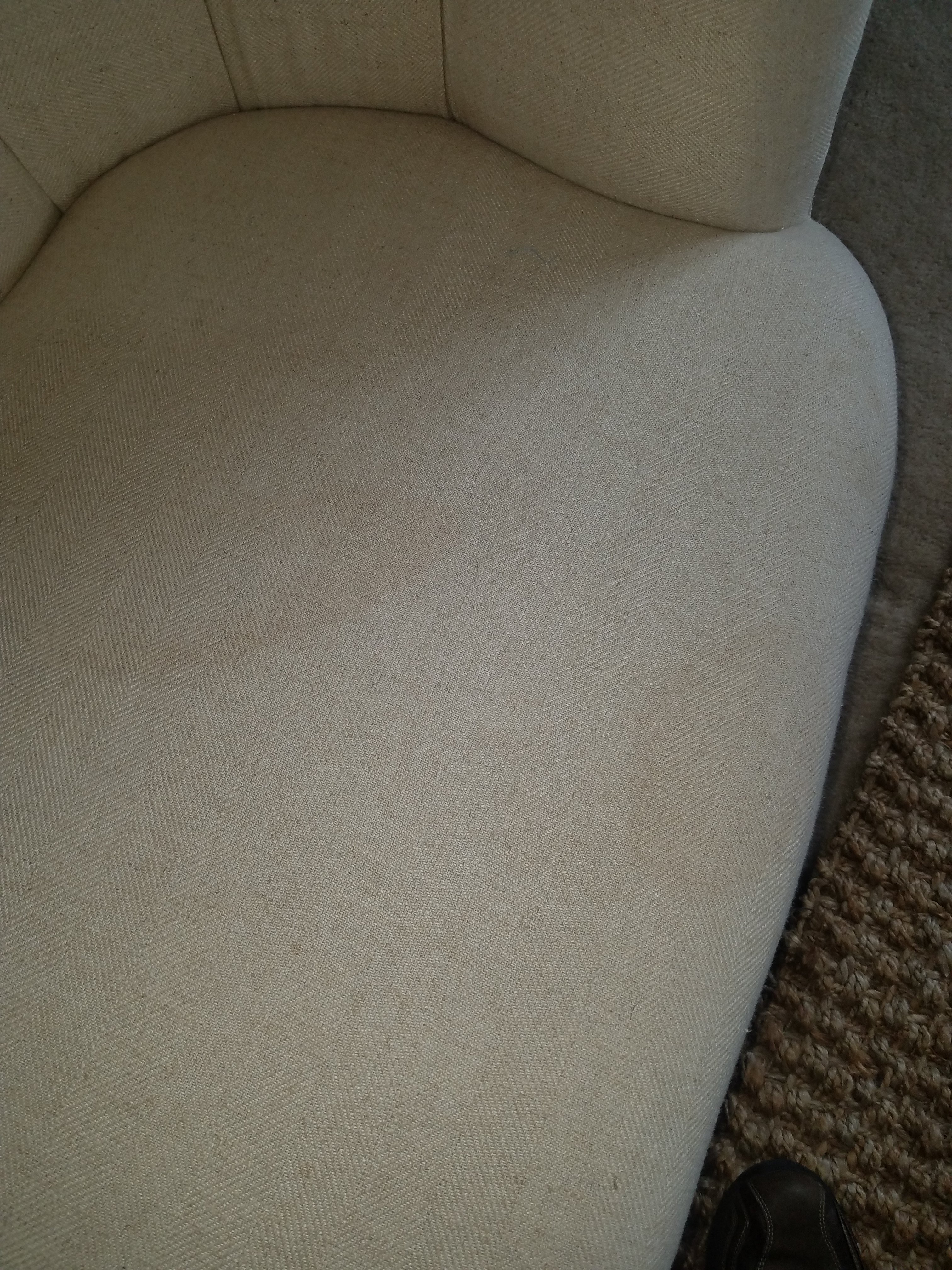

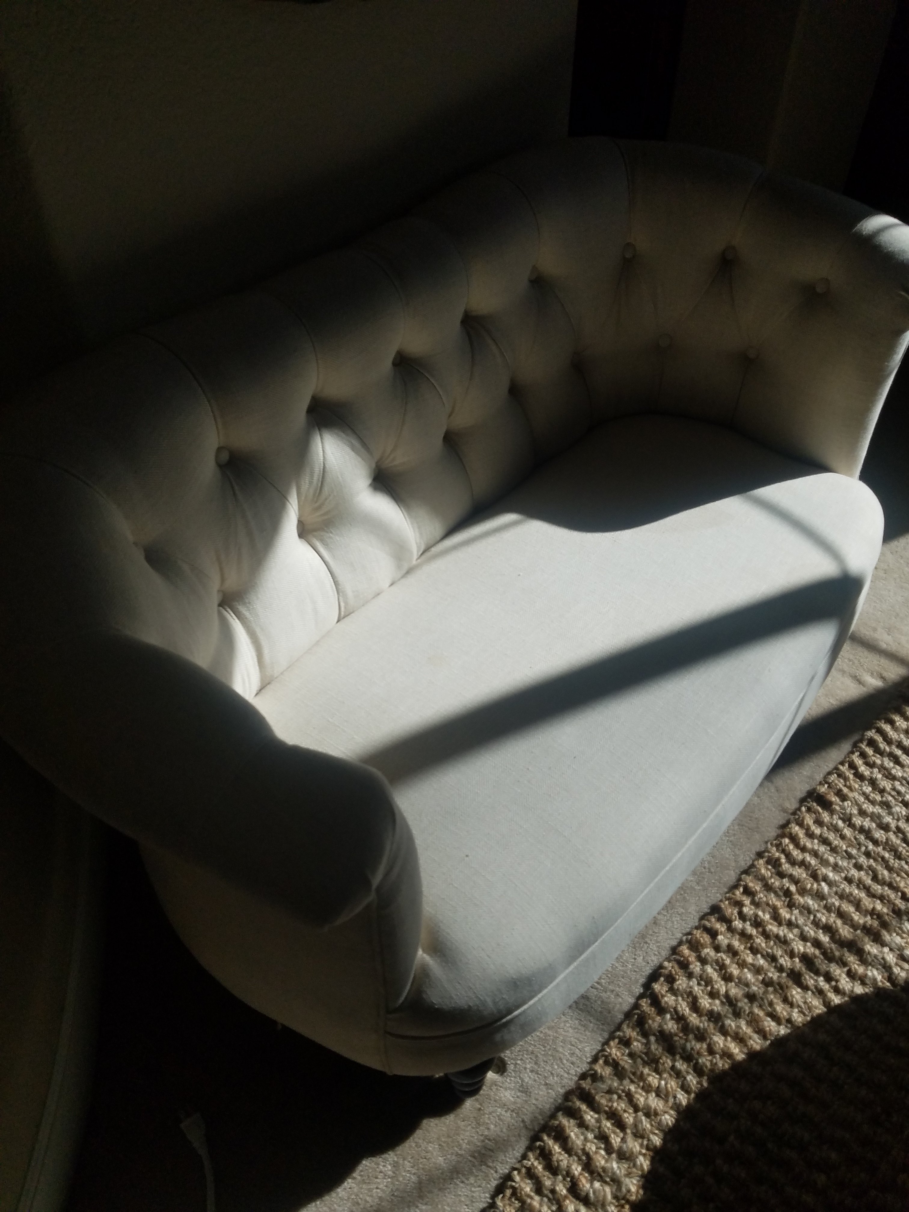

I have variable OP with 8 inch pads of cotton, and microfiber. On lowest setting is really gentle. Can it still be used on this?
The stains seem drink spill but maybe browned because cliemc attempted cleaning. Its not bad over all.
I thought use a little bit bone dry and agitate evenly with OP, force dry.
