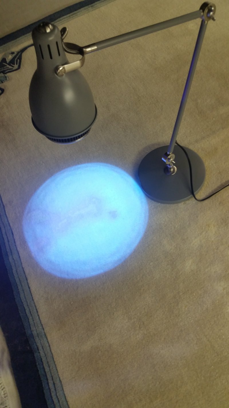

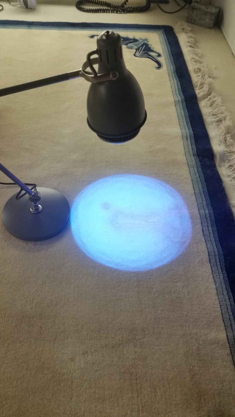

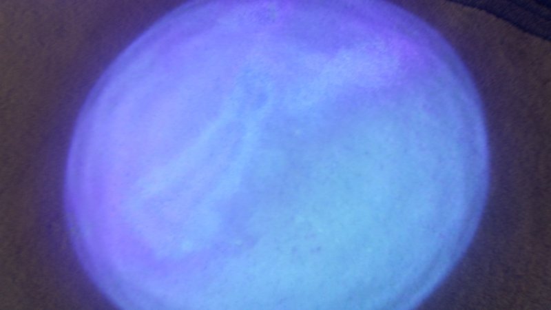

Yellow stains of unknown origin continued to exist even after two washes and a series of H2O2 treatments. The light is now being put to the test.
More results will follow.
