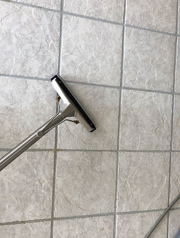

    Today I had a little tile job. As luck would have it, I ran out of my Viper Venom. Well, actually, I didn't run out. I hit a speed bump and the jug bounced out a hit the floor of my van, spilling out the contents everywhere. So in a pinch I used my SS Code Red. I'm seriously thinking about not buying any more tile cleaner and just sticking with the Code Red for my tile work. It cut right through all the crud.
    I then sealed the grout using Mike's technique with a flat microfiber mop and some Dynachem sealer, a.k.a. Seal-A-Cobb. Sorry for calling you Mellon in the video Mike :). Making a video and sealing grout with one hand is not easy.

    Does the sealer need to puddle up more in the grout for more adequate penetration to give it better seal?

    Worked it in, then apply a second coat 15-30 min later. I used air movers to speed things up.

    it was a bit faster than my trusty grout stick that everyone hates.

    I spray it down with a 2 gallon sprayer , then work it in.

    I fill a one quart squirt bottle and apply.

    I used power max on a couple tile jobs instead of viper. Worked good but a little harder to rinse.
    Scrubbed with crb and grout line brush around edges.
    Sealed just grout lines with viper and the little brush and bottle doodaddy.
    I'm really liking the tile work.way easier than carpet.

    2,500 square feet of tile and grout. Very dirty residential that had been color sealed.
    Sprayed down with Saiger Code Red and rinsed 500psi with a PMF tile wand. No scrubbing and finished 3 hours later... Beautiful.

    Looking good Bob. That grey grout doesn’t let you get away with anything. I’m amazed at how well CR cleans tile.
