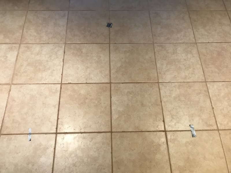

Here is the tile I'm talking about.. Does this look like color seal?

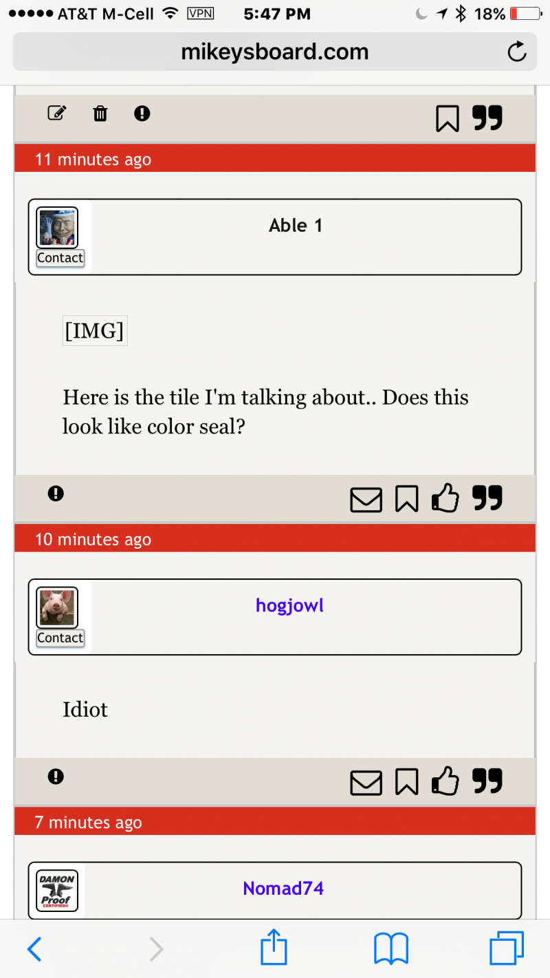

The pic. was copied and pasted from an email, does that not work?
Village Idiot
Jul 13, 2011
26,227
No. At least not by referencing the location in your email. That is secure/private
You can see it because you are allowed to see your email...we aren'T
You can drag/drop the image in a message , copy/paste the image itself, or upload the image

Photobucket.. It's been three years! So what say yous?

Lol, pic of the day! So wth is wrong with the tile?
