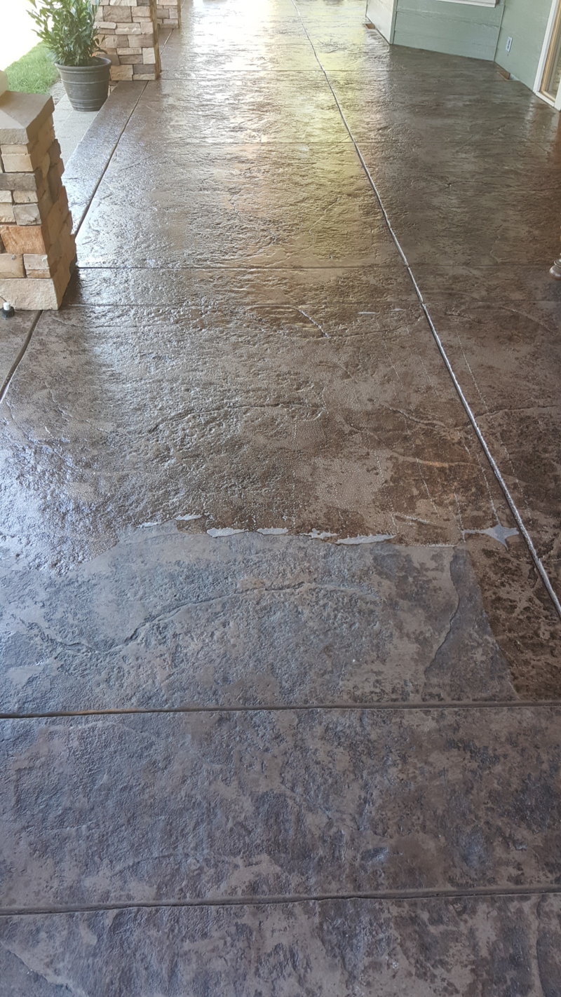

View attachment 16983 View attachment 16983 View attachment 16983 Stamped stained concrete. It is 3 years old. Total of 4 coats of sealer. After I scrubbed and rinsed it really didn't need another coat but since it was prepped I put one on anyway. I used a product called Master Kure. Solvent based acrylic curing sealer. It is theist forgiving coating I have ever used. The floor picture had been previously coated but the vertical wall had not. Pretty good uv protection. 100 for 5 gallons. I did 1800 sf with 5
Also added a non slip product the is Ground glass.
