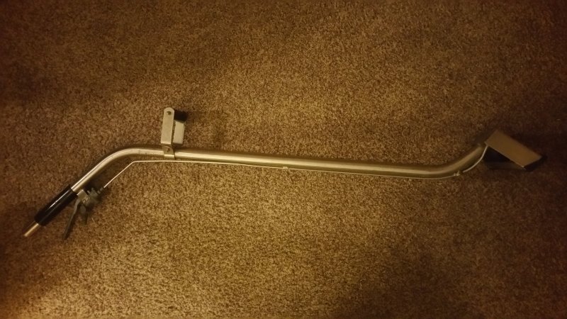

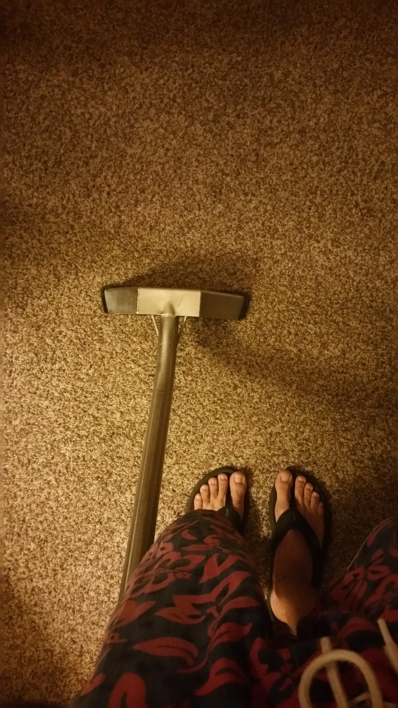

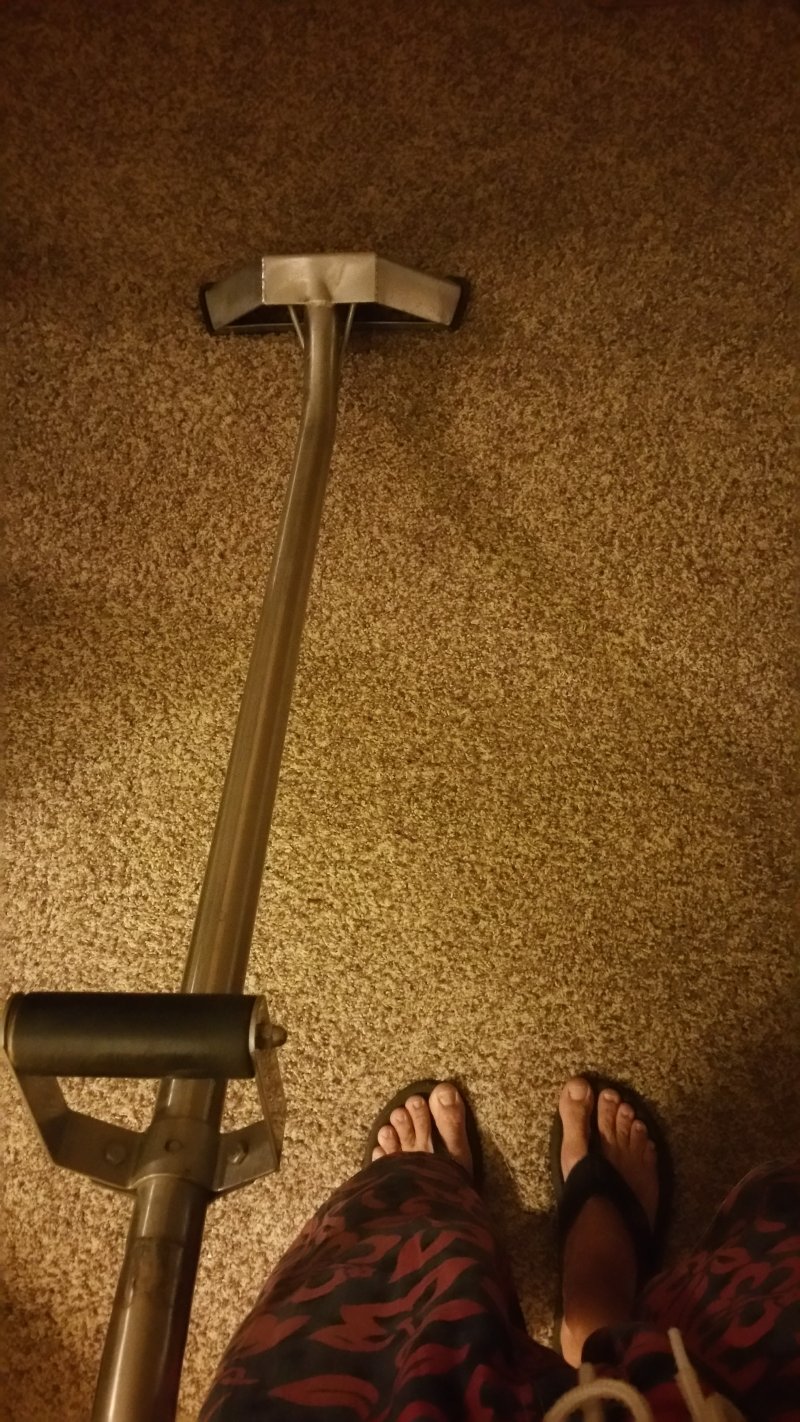

I do large (50-80ft) yacht (sportfishing) boats sometimes. There is no room to turn around. I'd like to bend this wand up at the head a lot sharper so that it hits the carpet with the head flat and glides well...and so that it would be much closer to my feet (imagine cleaning in a closet, with walls you can't scratch). I'd move the valve holder and cut 12 to 20 inches off the end. I'm 6'1" if that matters.
At what point would the main tube be too steep? Would that cause it not extracting properly? I don't have extra wands to experiment with so once I cut this one I'm comitted. Thanks for any help.

I don't see where altering the bend would affect the suction.
However; once bent, stainless can work-harden. You might consider taking a vacuum cleaner wand and do a full sized mockup. Buy an exhaust tube bender from Harbor Freight and tinker until it is perfect.
Then take the mockup to a good exhaust guy and have them cut, heat and bend your stainless wand.
Get it right and there may be a market for such a wand.
Test different angles to see how far you can go before you loose a good seal.
You should be able to hear and feel when the angle is too steep.
You may be able to modify a glide face to compensate.

That's why I'm going to increase the angle of the bend at the head to keep the face flat...
At some point I feel it would be to steep. If you take it to an extreeme, a swooping 80 degree bend at the botom would have water comming nearly straight up...that's gotta slow down the process...I think.

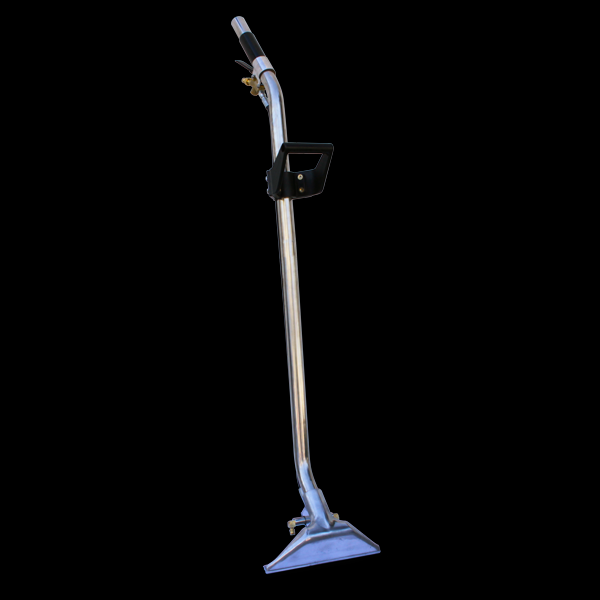

I had a friend cut down an old wand I had for the same reason, tight spaces. Unfortunately he welded the head on upside down. Never got around to fixing it.
May 12, 2007
2,519
Bay City, MI
Bruce
I have an old PMF 802 which looks to be the one in the picture, if you figure it out us know , I would also like to modify mine for boat cleaning. I have the PMF Mach 12 which is a little bit taller then the 802 and even harder to clean a 50ft boat.
