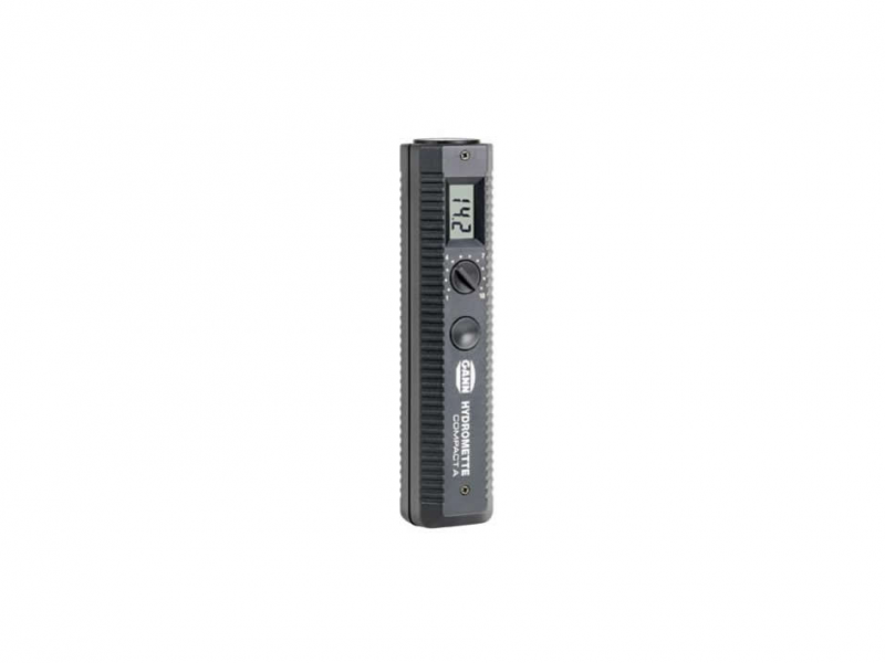

  11. kmdineen
    kmdineen
    Joined:
    Oct 18, 2006
    Messages:
    411
    Location:
    Redding, CT
    Name:
    Kevin Dineen
    Gann Moisture Meter G2020
    Gann Moisture Meter G2020 ‐ COMPACT A
    Order# 2020
    Use to measure finished hardwood flooring materials Digital readout Measures materials 1.5” thick Readings are in % of moisture content Separate seƫngs for different species of wood No cables, no electrodes.
    dealtimeman and tres davis like this.
