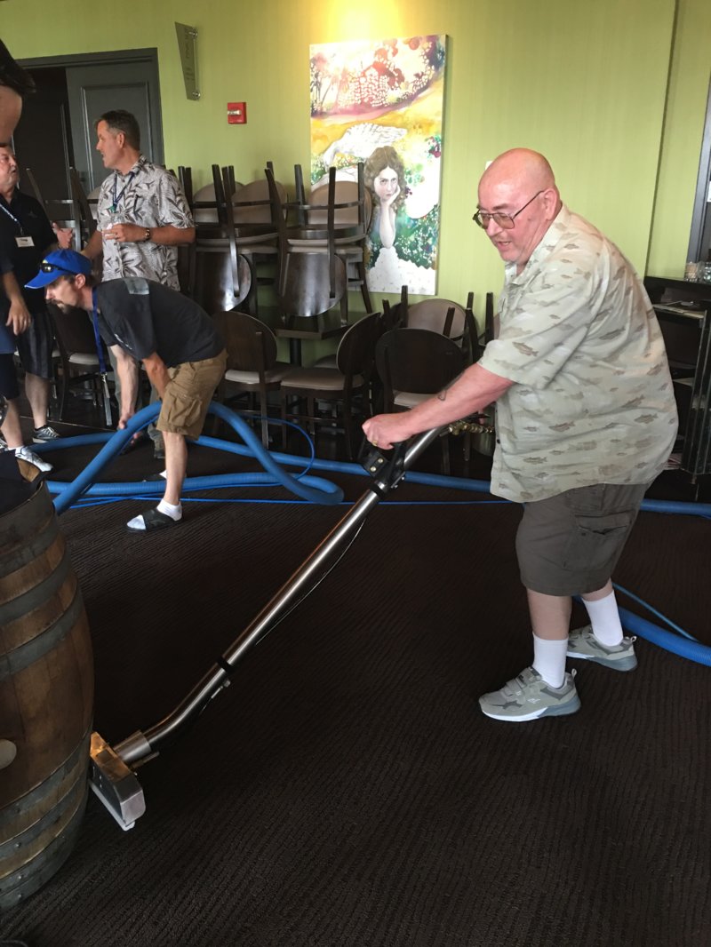

You know when you clean with a Vortex/Aerotech you can "cheat" and skip pre scrubbing or rotary extracting due to the combined magic that extra heat, vacuum and flow the big rigs create.
After a month or so of use with this magic wand I'm finding that everything happens quicker, deeper and drier AND HOTTER.
Why hotter? The water stays in the HX longer. Rather than being heavy on the trigger with lower flow and slow passes with a lesser wand, the Magical Devastator POWS the bejebus out of the carpet (especially Poly) in usually just one pass.
The 370 just POPS with this wand attached. Amazingly so.
My CRB and RE are seeing less and less use as my faith in this beauty goes up
but for the love of mike, get me a slot glide. Who ever though this mini slot thing was a good idea needs to have their head examined.
and I can't wait for the 12" FMF version as this bad boy is a tad heavy for this aging rock star..
The next two MF's should be devastatingly wonderfull

I have talked with PMF and everything is looking great, I will do some testing with slot glides, and see what I can come up with.
I am hoping everything comes together for MF, it would be killer to be able to show the latest creation.

Ya because the lock down isn't bad enough, but I could see guys with a smaller blower push it real good!

If I do slot I really think it would need to be narrowed down to cut back on the bite. The good thing is the velocity going through a narrowed down slot would probably help even more with dry time.

any slot will bite down because it acts almost like a non glided wand. a hybrid works great. also a holed glide with larger than normal holes would work really good.
Sapphire made their vac relief to start leaking at 8" and full open at 12" hg. Prochem is probably about the same. i have a cobb vac relief that opens at 15". a slot glide with that much lift isnt necessary especially cutpile resi carpet. i have a old hole glide that i will make the holes bigger and see how it works, but it will probably be very similar to a hybrid. lots of suck but still not too hard to push.

I find I use the slot most, but it's nice to be able to switch to a holed at times to.
Switching is easy peasy.
