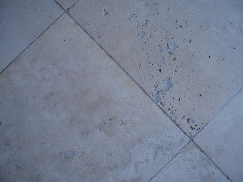

She had 800 feet of this that she attempted to fill some of the wholes with some miracle puddy she found on line and then sealed with with Home Depot Tile Lab topical junk..
We tested it today to see what to expect.
Took a razor to the over fill and some acrylic stripper and a hogs air to the sealer.

After we strip it we're gonna use some of Stone Pro's Traver fill on the holes in the traffic areas.

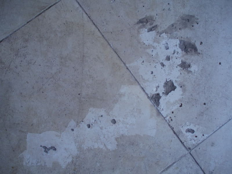

The first pic is after I razored off some her goopy job from years ago.
When its all said and done the bill will be over 4Gs.

These homeowners are such extreme pigs that anything I do will soon be covered in gunk.
She is probably the worse house keeper I've ever seen.
They could not have picked a worse floor for themselves.
Anyways, a Green pad and Acrylic stripper and plenty of time and "healing" got the Tile Lab junk off.
I'll be applying Dry Treat after I strip and fill.
