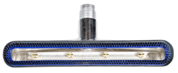

Does anyone have any experience with the new Gecko 12" head?
112,314
I have not tried the Interlink tool, have you?
The angle of the vacuum connection on the wand looks wrong to me, why not straight back like a carpet wand instead of down? Maybe the gun handle makes it work..
I think it needs to be 2" too to speed up the velocity.
It looks like the manifold could be tapped to fit two or three more jets...
I couldn't find a video of it in action on YT..
Thoughts?

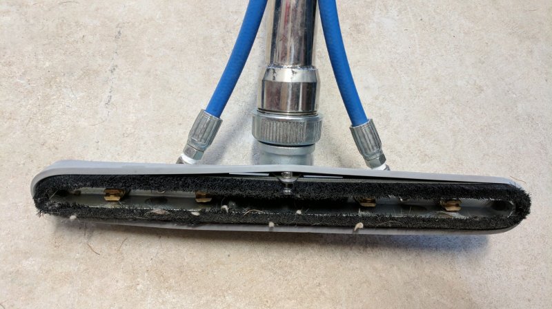

I have an older version and yes 85% of the vac hole is obstructed. What MORON designed that?
But don't know if the new style head will fit this older version. But EGADS! it's expensive!

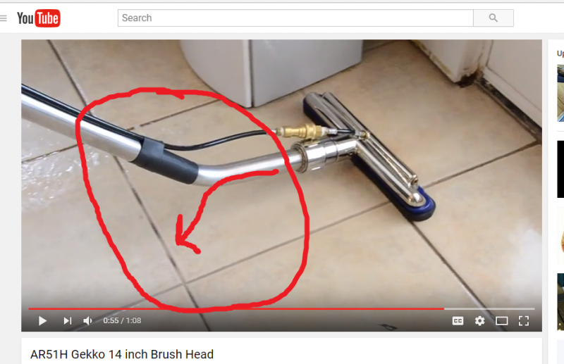

AR51H Gekko 14 inch Brush Head
I know that's not the 12" head you're talking about, but watch the video of the 14" in action. Either they used a crappy prespray, or the psi wasn't high enough, or it's just a crappy tool. I was not impressed with how long that neck is on it. How in the world are we gonna be able to get in narrow spaces with that. Heck, even the 12" will be too big for anything narrow. I guess they want you to buy the other attachment, instead of just swiveling it. I don't like it

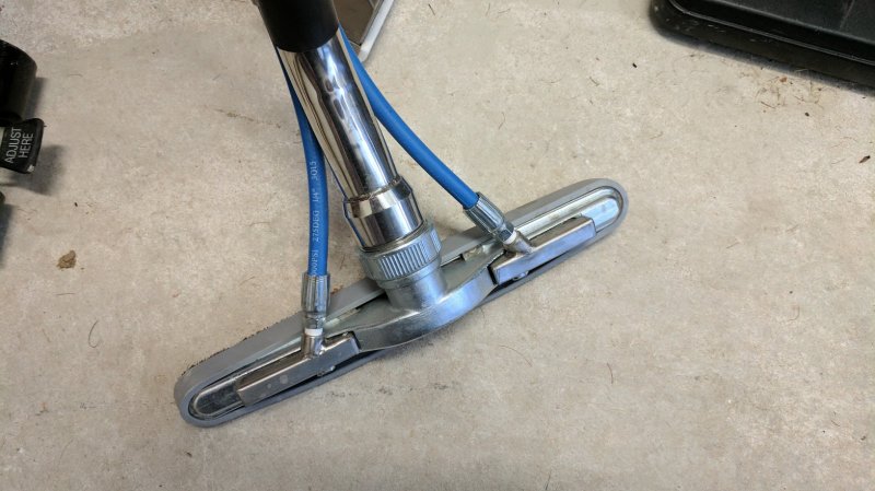

I have the new gekko tool and so far it works great. The manifold is redesigned so it's a little beefier and doesn't block the vacuum port like the old one. The rubber skirts are a little rigid but should loosen up in time. Better connection fittings makes it a little easier to change heads.

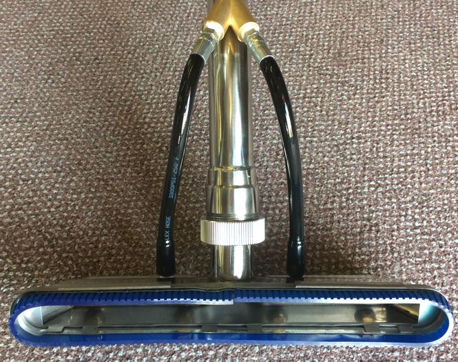

We have been working with Wespak on the 14" Squeegee Tool for several months.
Four #110015 1/8" Brass Jets cover the width well.
The Urethane squeegee is durable, and the "Y" fitting keeps the plumbing neat & out of the way.
Brush head slides on as well.
http://www.cobbcarpet.com/zen/index.php?main_page=product_info&cPath=76&products_id=5467
Does that kind of squeegee head lock down on the floor where you can't push it, like the classic squeegee does? I threw mine out the door.
And does that head swivel or is that just where you can loosen that head to remove it?
