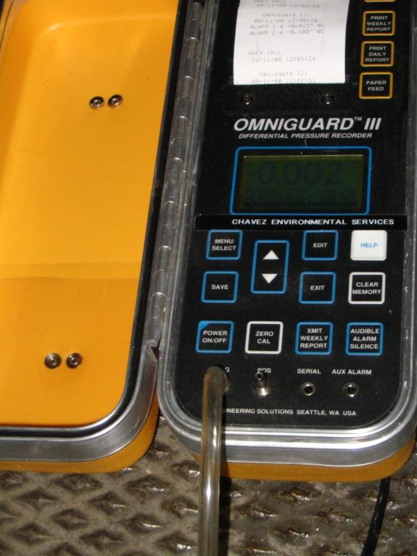

When you're tired of Cowboy'n through it or if the job is critical to the point that there could be some litigation involved, I recommend a manometer be used.
The manometer read the neg air pressure in pascal scale and prints as proof that you maintained neg air pressure over a period of time. To be safe, I would not pull more than three pascals from the built environment.
We don't use it all the time but when you have a client that is overly concerned, its nice to be able to prove you had control of the air.
I'm glad you showed me a picture of that. I am going to make one out of cardboard and walk around the house with it. I love to astound people with my sophistication.
I'm gonna put a Chavez Patent sticker on it.
That's a $600.00 meter but you can get a digital manometer off ebay for around $60.00.
It wouldn't have a printer but you could take a picture of the pascals being pulled and would still be handy to prove to the client or when billing an insurance company.
