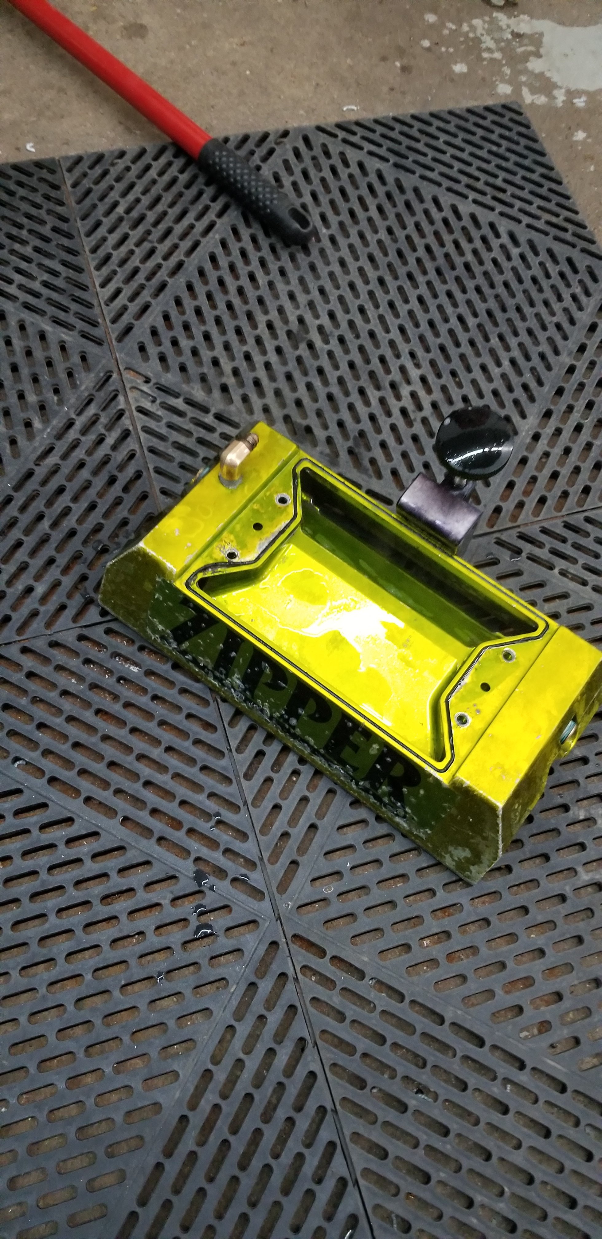

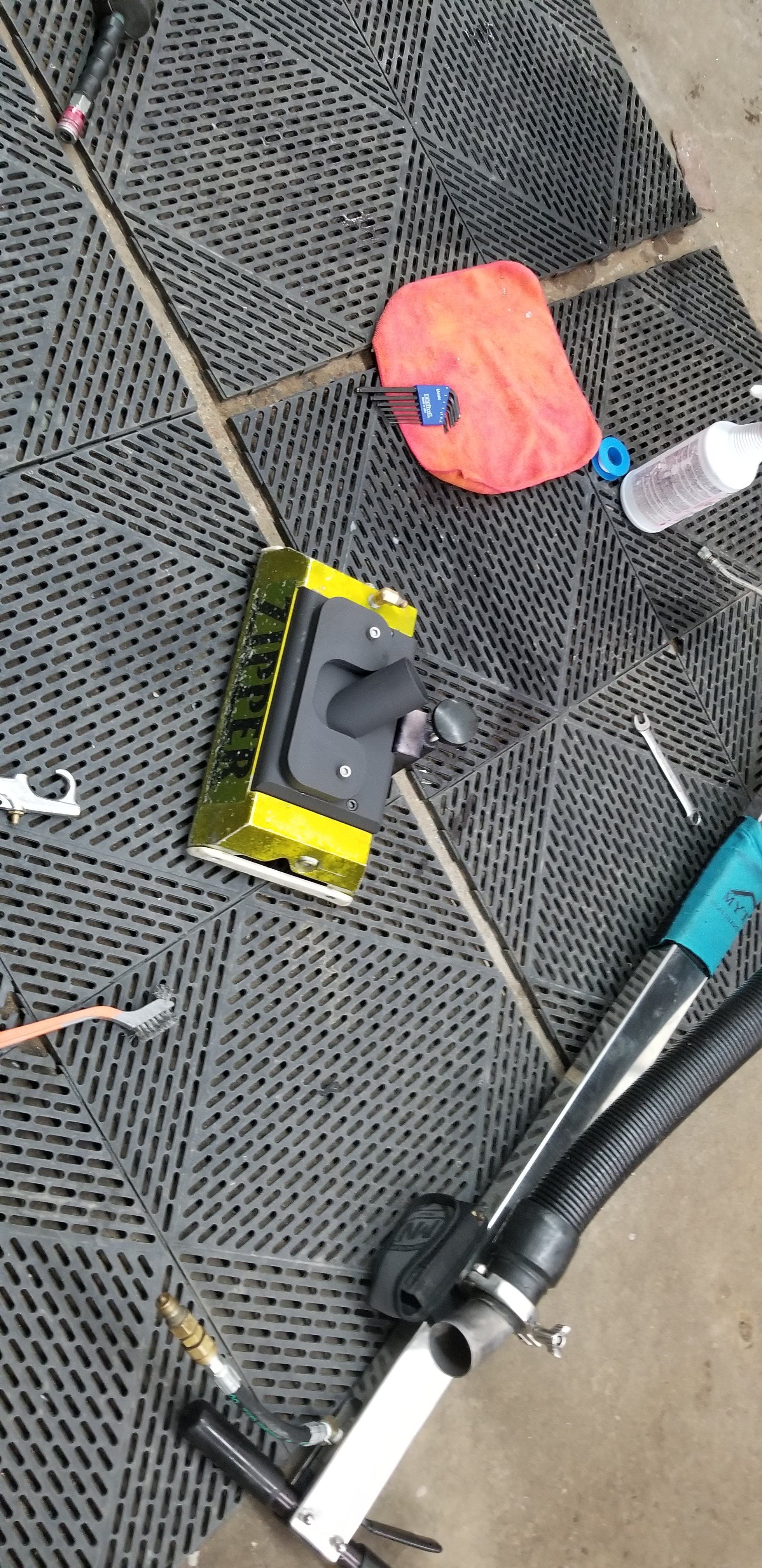

Worked on equipment today

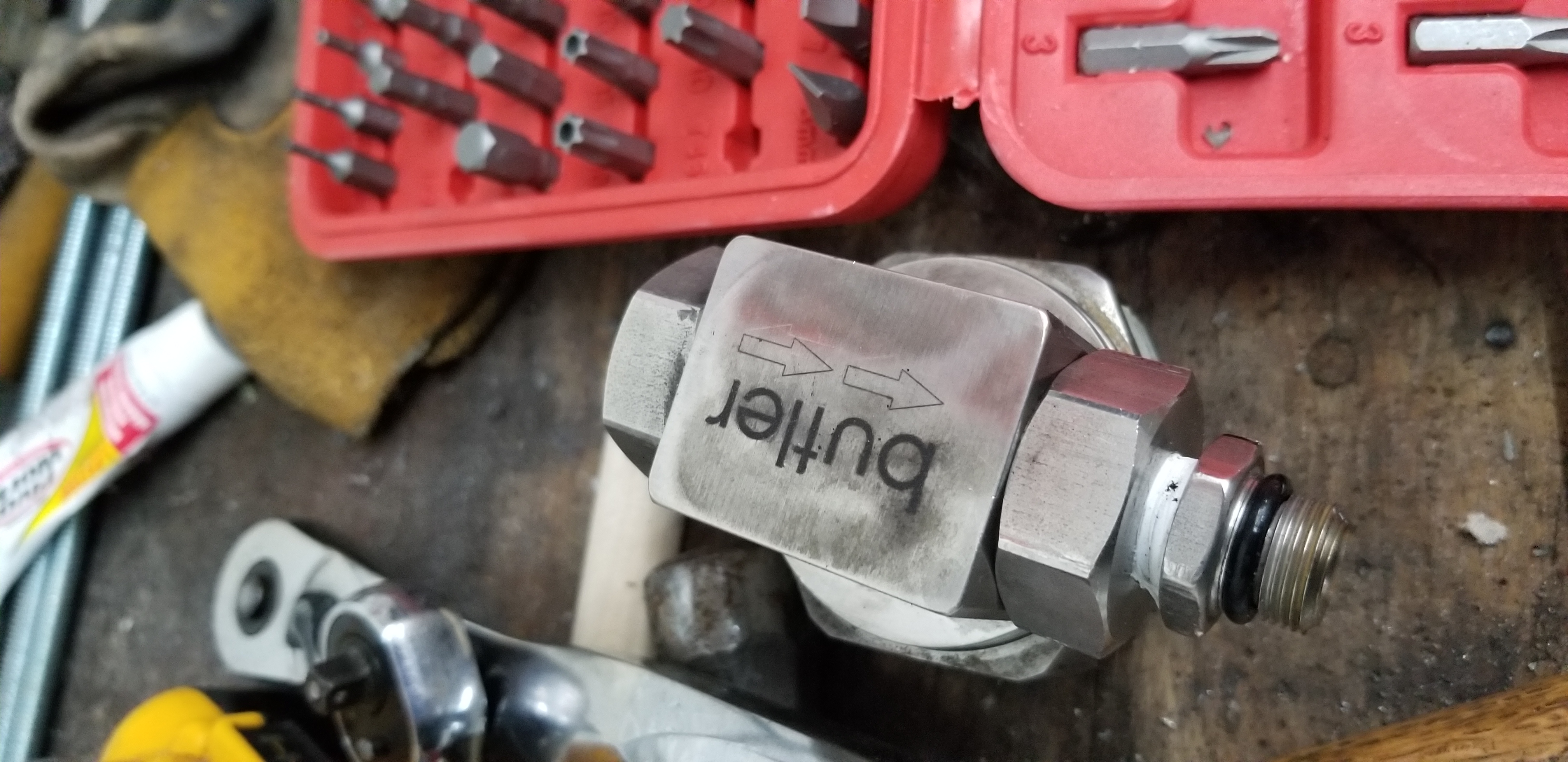

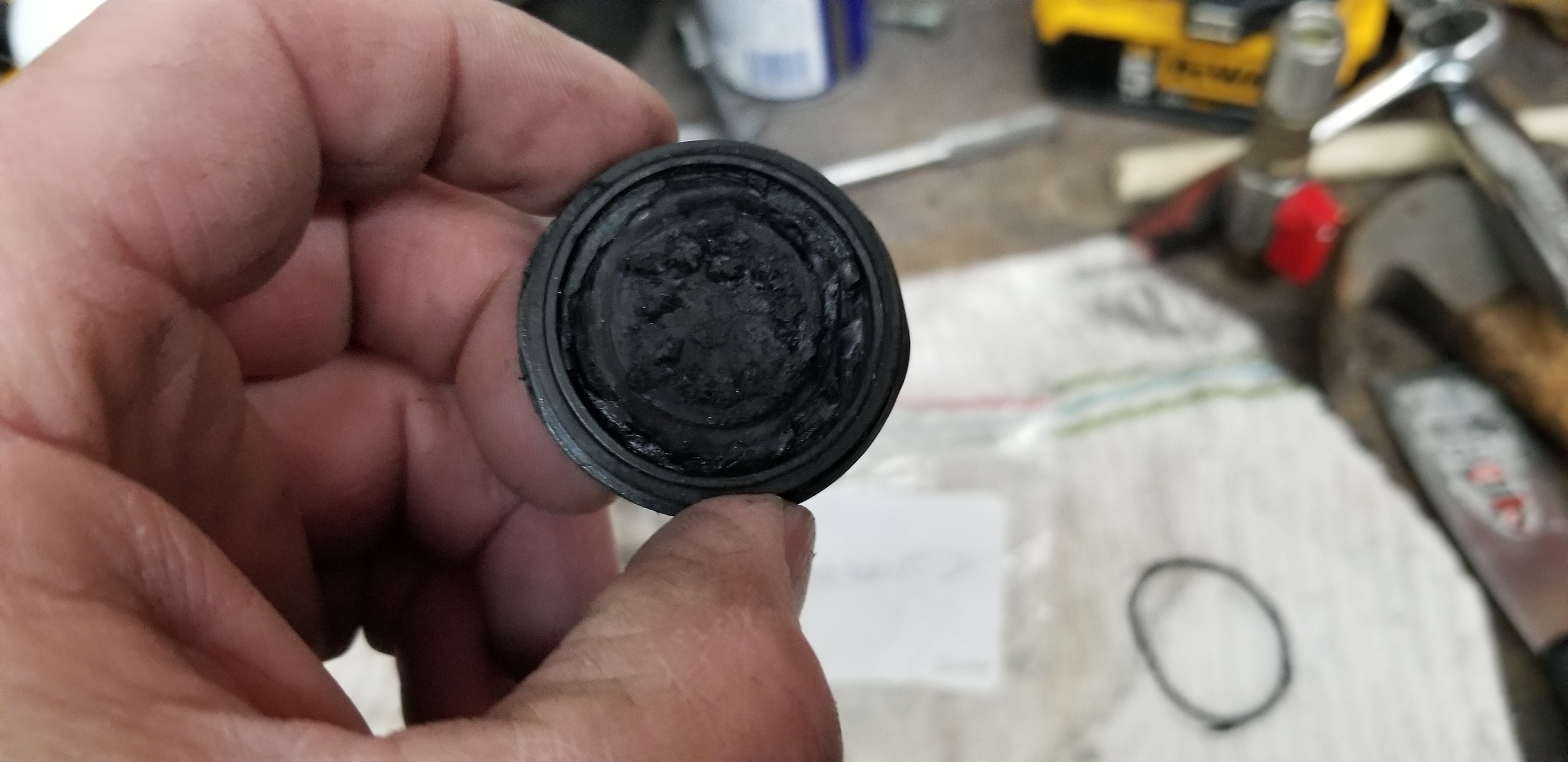

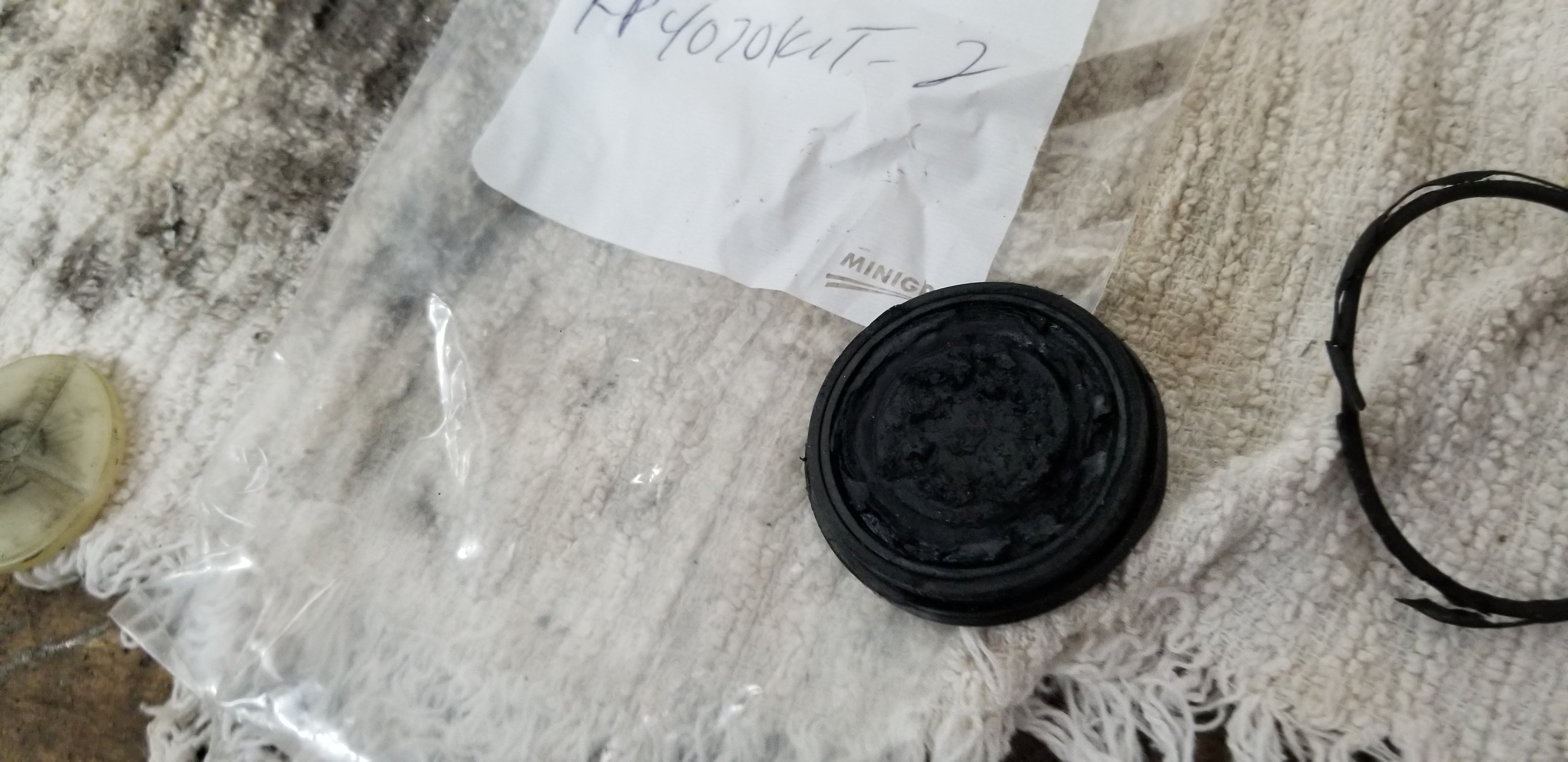

Rebuilt chemical injection (I carry rebuild kits)

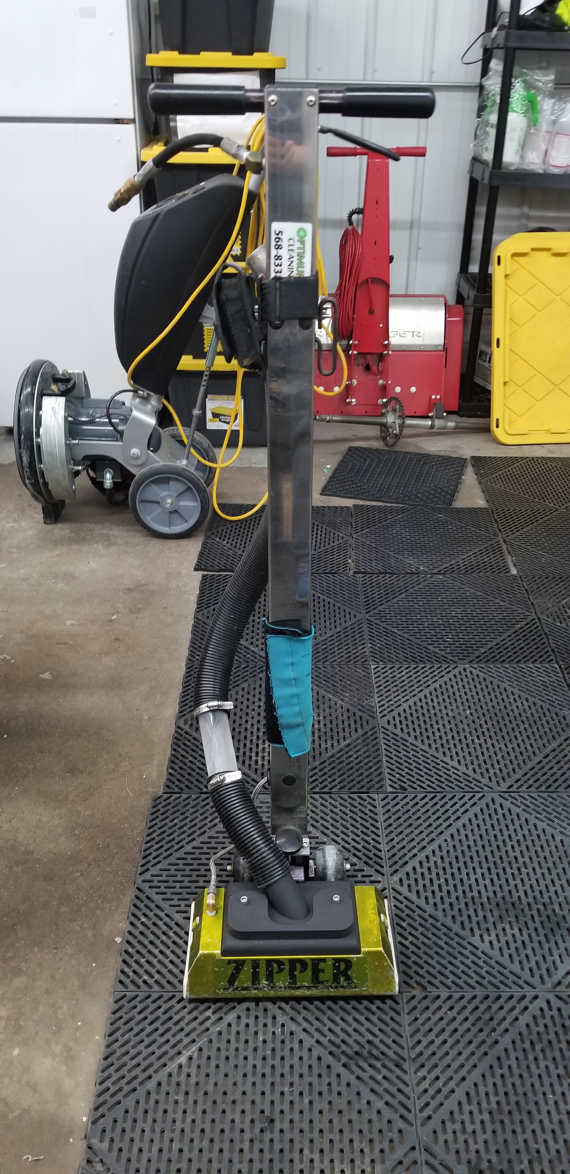

Worked on getting more suction

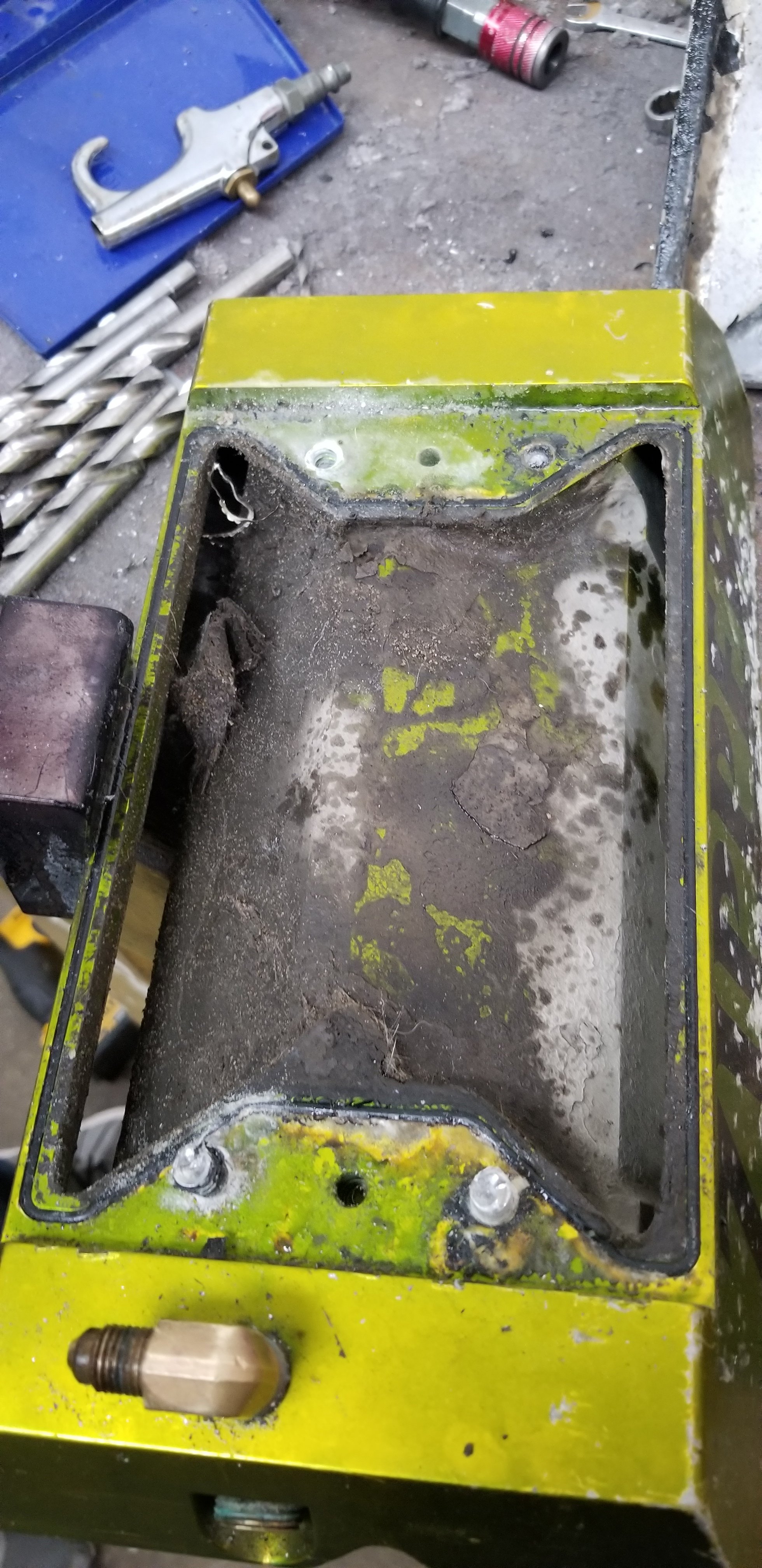

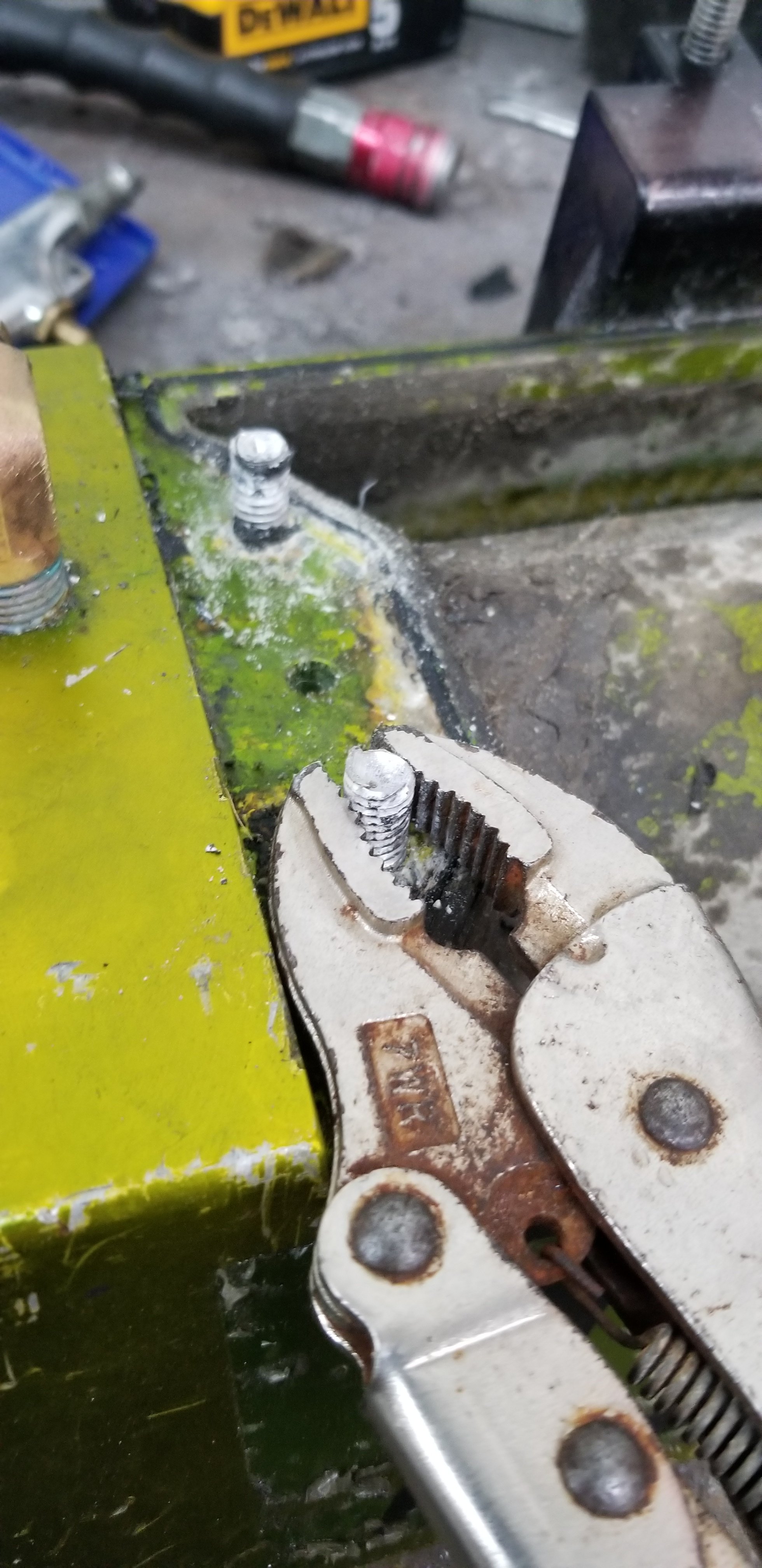

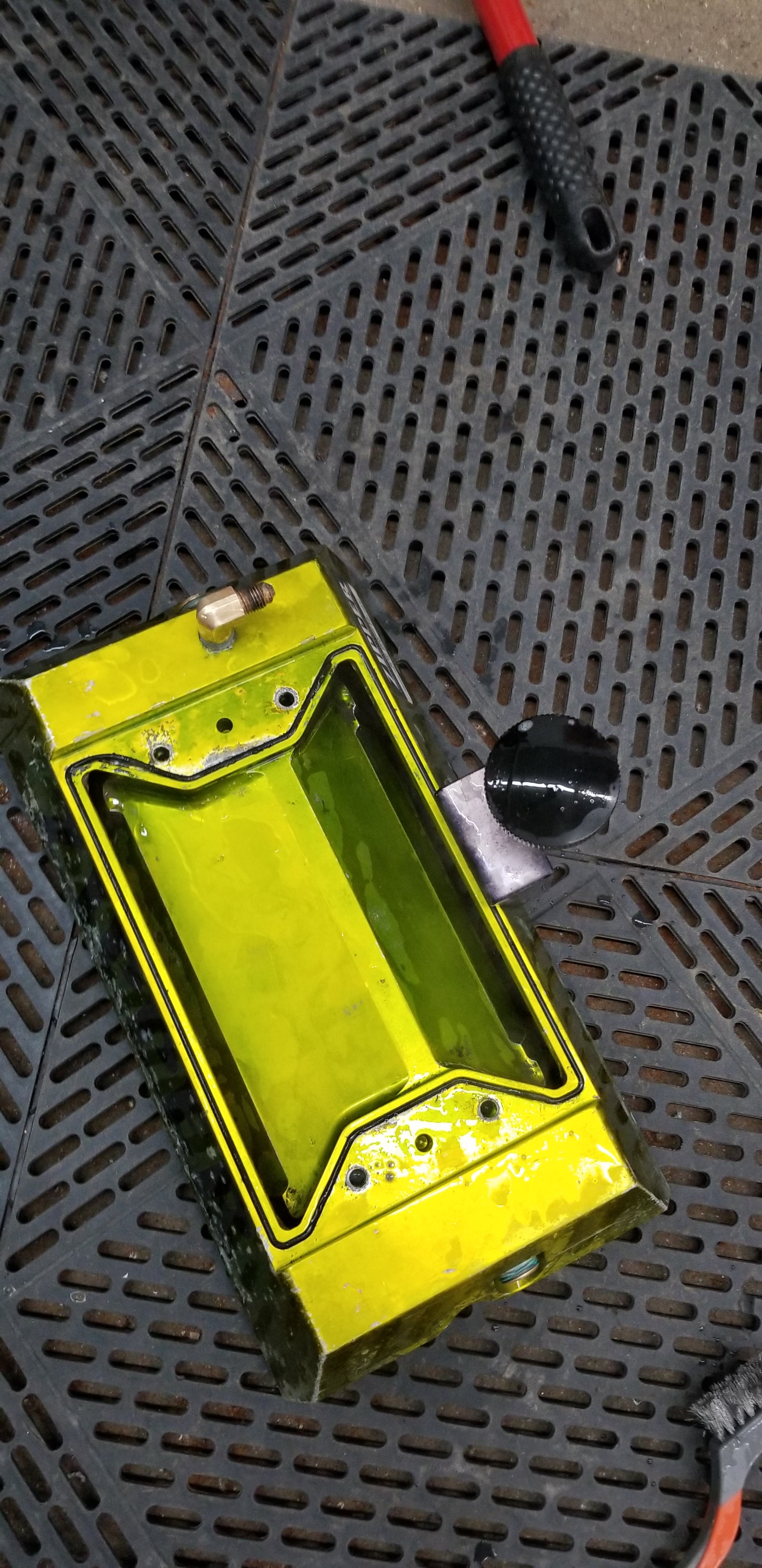

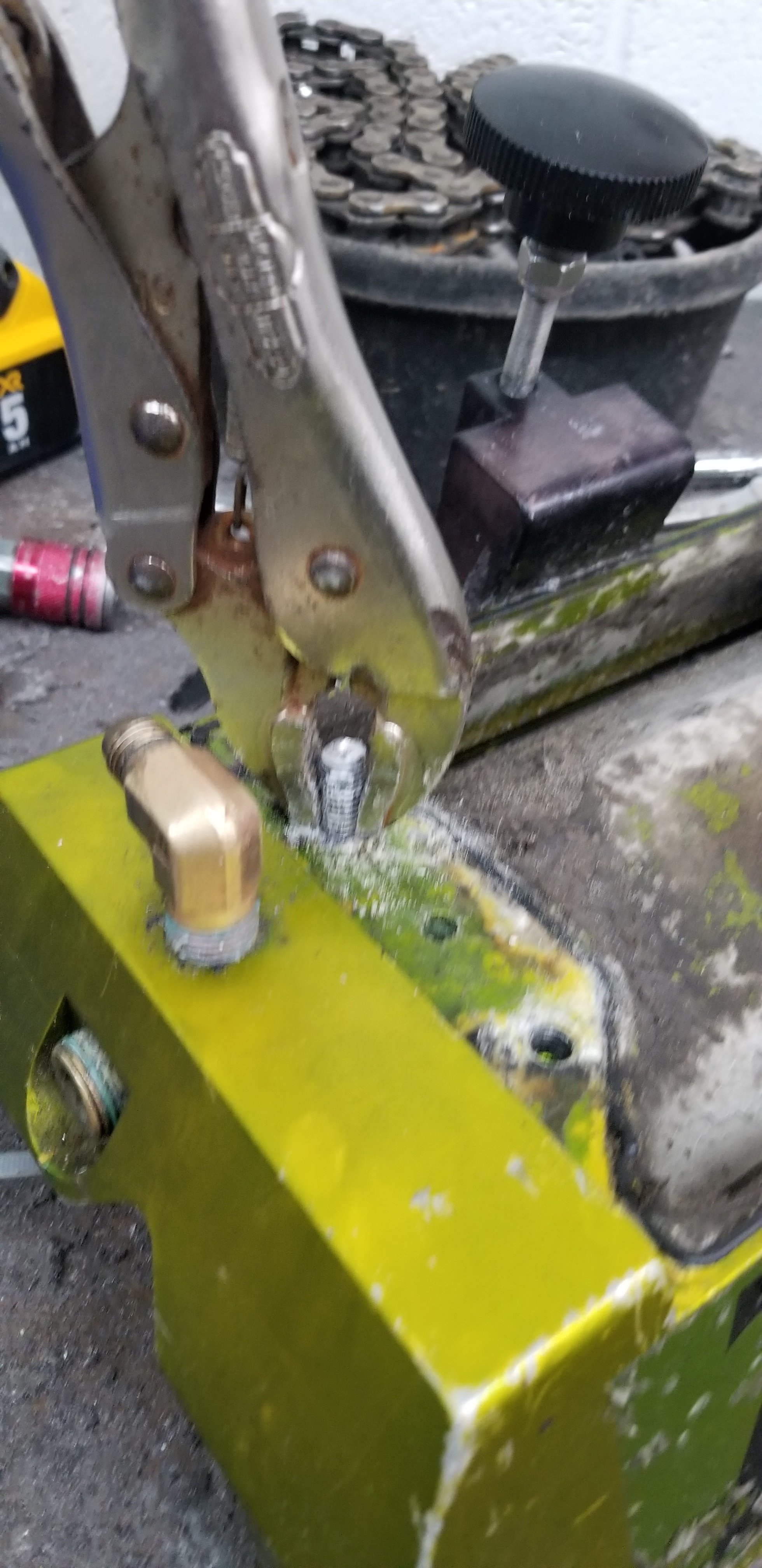

Worked on Zipper that they didn't realize needed maintenance.... Didn't take pics of the underside... But needed major attention also :( Had to drill the heads off 2 bolts on the lid... Got super lucky!
Sanded and painted the lid and weights with high temp BBQ paint
Got way more sucky sucky now :)

You were using the Vice Grips backwards. Put the clamping lever the same way as you want to rotate it, or it can loosen as you apply pressure. Other than that, and other than you are a glutton for punishment and other than you somehow seem to have won Marty's heart and other than you insist on living in the North country, well done. seriously.
