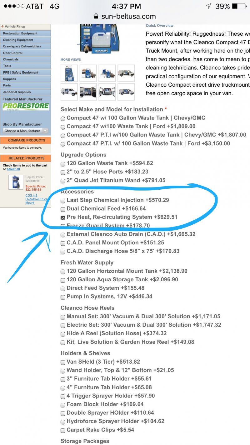

175 bucks for 75' of garden hose seems a real good deal.:hopeless: Hose cost more than the reel.:headscratch:
Surprised last step chem injection is an option, who would buy without it?

3 Years ago, I would've bought without it. You'd be surprised how many carpet cleaners rinse with just plain water. For 11 years, I always thought the added rinse was a ripoff.
I had the mindset thinking "if I rinse my hands, car, laundry, and hair with just water...why do I need an additive to rinse carpet? I started using an acid rinse on wool rugs only, then at the beginning of 2016, I introduced acid rinsing into my normal jobs.

Yea, I (kinda)get it, just make no sense.
Suppose it's a nasty, hard to run an occasional emulsifier with out one.
Or whole room odor issues. Chemical injection I can add a couple cups of odor product to the head pack and it will help a little.
Seemed odd(to me) that it's not included.
