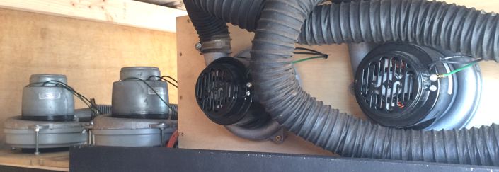

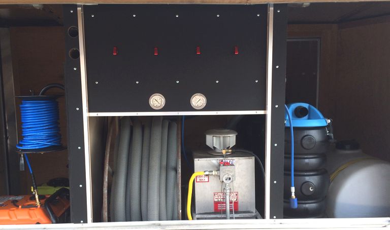

While this is a customer built prototype, it proves the performance capabilities of ETM's. It can run on a single 230 VAC cord, or generator as pictured. The owner is Mr Carpet in Denison, TX. Currently it has two 8.4" Lamb Vacs, two 6.6" LX vacs & Little Giant heater. We demoed this ETM in our showroom yesterday with the owner & several TM customers with a 14" wand. Consensus was the same . . . It performed as well as their #4 blower TM taking out some black stains. We also did testing with our digital lift gauge at the wand while cleaning, which confirmed the performance.
Larry Cobb
5,795
Dallas, Texas USA
Larry Cobb
The 8.4" vacs have over a year of service on them already. Owner probably has the hours on them.
The 6.6" LX vac will last considerably longer since the larger bearing is shielded better from moisture,
and has a rated life of 1500 hours.
All LX vacs would have improved the performance.
We measured the lift @ 9.2" hg. at the 14" wand while cleaning on the carpet.
I didn't check it, but this would be ~10.5" hg. at the truck while cleaning
The WorkMaster we owned back in the 80's cleaned as well as an entry level TM. But the hassle with heavy power cords made it impractical for everyday use. Pulling the stove would be a pain. Too many risks of vinyl, wood, stone, tile damage.
Then if you're going to use a generator it kind of defeats the purpose of Electro mounts, doesn't it?
It has much more value when the day of fuel becomes prohibitive for cleaning machine use.
I'm puzzled as to why they chose the electrical route? Also why a trailer vs a van?

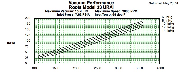

and how much air was being moved at these lift levels? Lift by itself is meaningless
does one of your 33blower truckmounts perform the same as one of your 45 blower truckmounts at peak lift @3500rpm?
What is the difference in "working lift" between the two at the same RPM and similar plumbing?

How much more efficient is a vac motor (or 5) compared to a pd blower?
We know that most pros expect at least "45 blower performance" when cleaning carpet. Using the old school roots 45 urai curves I posted earlier we can see that at 80% of max rpm and 14" of lift around 12.5 HP are required to get the minimum performance a pro expects.
That must be some overkill since rule of thumb says around 3/4hp per 115v/15a outlet.....or 7hp or so when you move their dryer and it doesn't work next week or BBQs their house
How much work is required to move water/air to the truck 100' away at the rate a pro expects?
