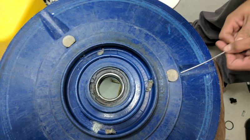

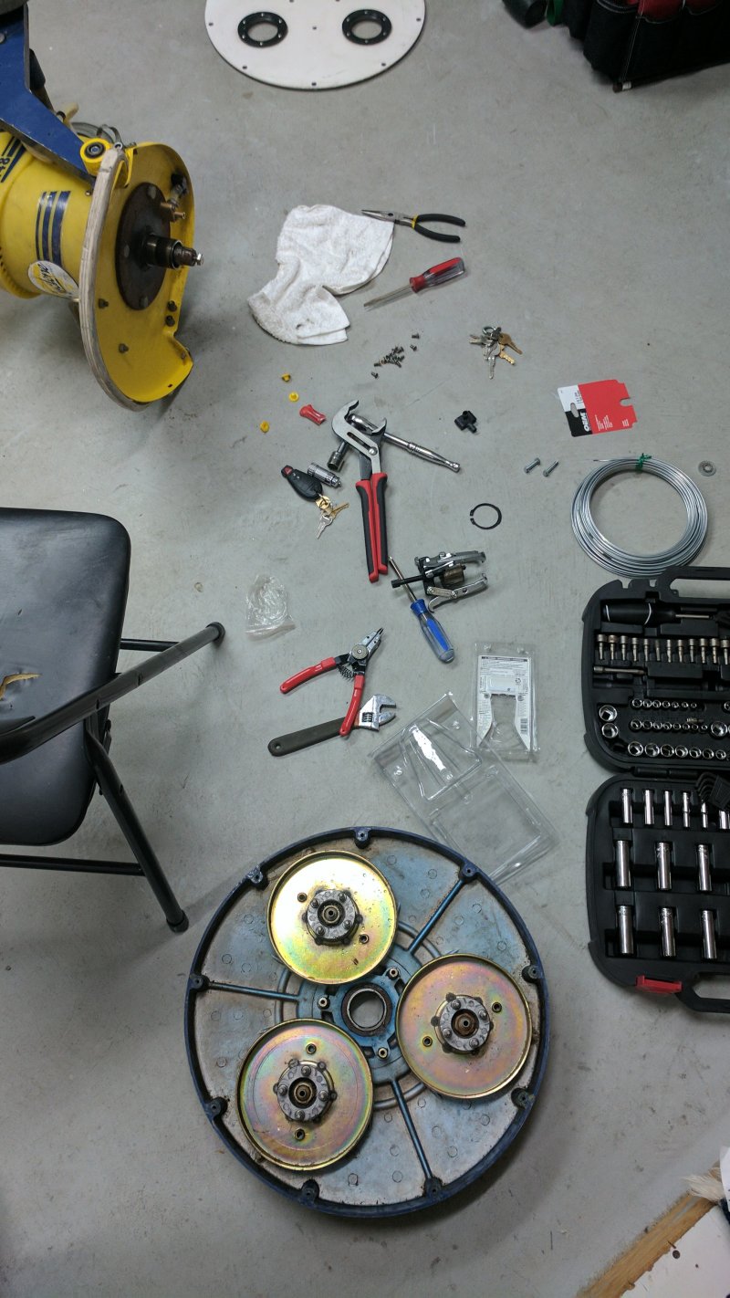

Our Cimex bowl was over flowing..
Thought it was the feed hose, turned out to be plugged plumbing...
You can see the clumps of sutley in the bowl after we ramrodded the three drains
Huge thanks to Rick for letting me bug him after hours
We've never had one that plugged up. We try not to leave solution in them. We pull the hose and drain into a bucket. Occasionally we will leave some in but it usually isn't a problem. Once a year when we clean them up and repaint the wheel, we pull the caps and flish they drain system.
We have spare caps. We get them from Rick. They often get damaged from pulling them out.
