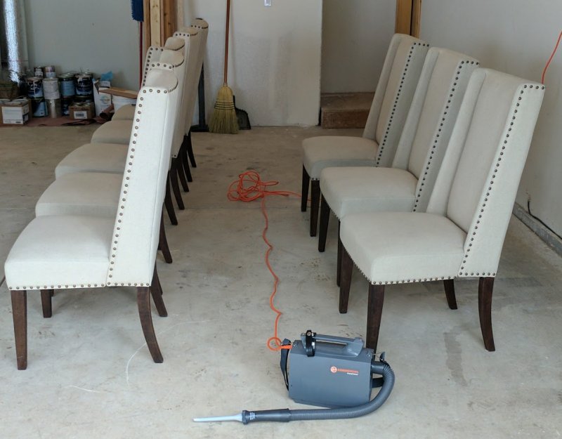

My recent cleaning of these linen chairs got me thinking about brass tacks..
Is there a way to test (the countless variety) tacks to see if rust is going to be an issue?
I know it's best to not get moisture near them but as you, I and Murphy know, spots always happen in between them...
and if rust occurs, how do you correct it with out causing more?

In the old days we sprayed an oily solvent on steel ones specifically, to coat them just enough to get through the cleaning, and then wiped them afterwards. That was so long ago, and I am so old now, I don't remember what it was we used. I'm guessing it may have been Pyratex.
12,075
Wd40 will probably cause resoiling.
As Tom mentioned, a dry solvent spotter or solvent based protector will work.
Most rust on cellulose fibers will come out with citric acid, though rust is pretty rare these days.
Reactions: T Monahan
not WD40?
Clear silicone will do it. But if over done can be an oily mess. I used to only do it on the old tuck and roll natural velvets.
Low moisture in thoses areas will prevent it. Then just buff it dry with a towel. I've never had an issue with rust. Browning if anything just because can't vacuum across it very well.
