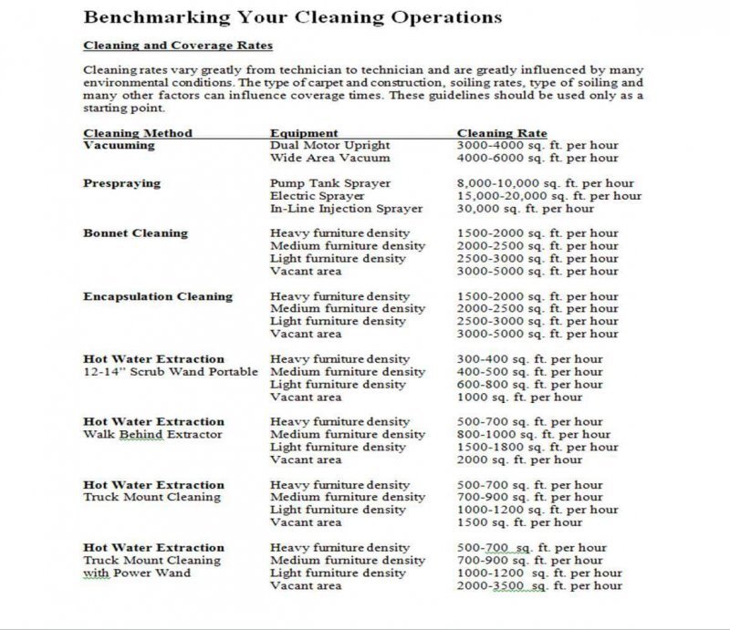

Just follow this format and youll be all set. Take account for the alzhiemer roamer density tho, highly variable.
