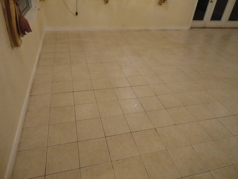

This was a non profit health care clinic that hadn't been cleaned in about 8 years.

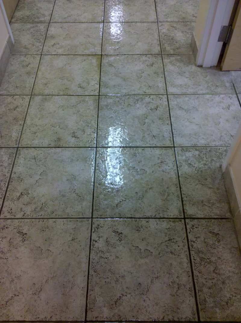

Hell its worth a try, i like this pic because its actually removing floor finish someone had put on.

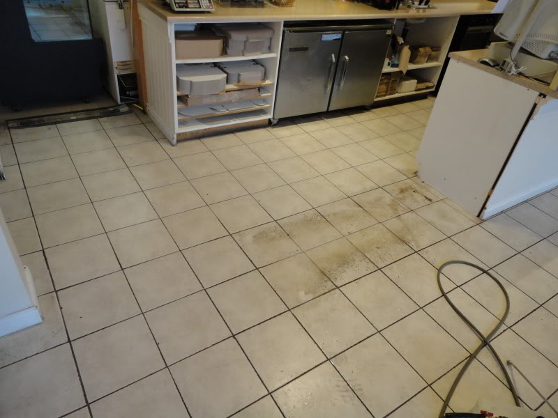

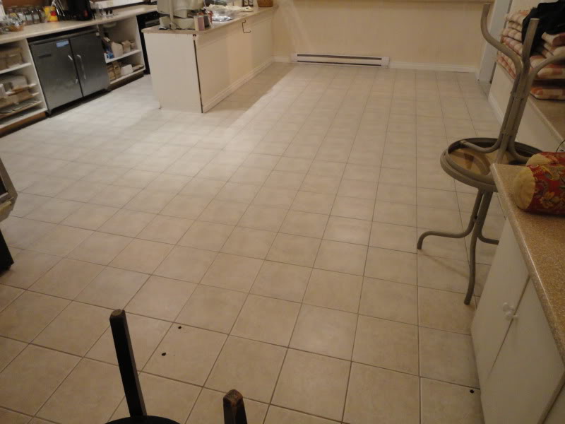

Here's my first T&G job.
A bakery that had only been mop cleaned for 8yrs.
We were thinking of grout sealing as we didn't know how well the grout was going to clean up. Fortunately it cleaned up nicely. Used O2 with Hotsauce and Attack. Scrubbed with a Whittaker and rinsed with Mytee Spinner, 1000psi, 240F
Used a pressure washing gun with an 01jet to clean the edges where needed. The Spinner got right up close to the edges along the walls.

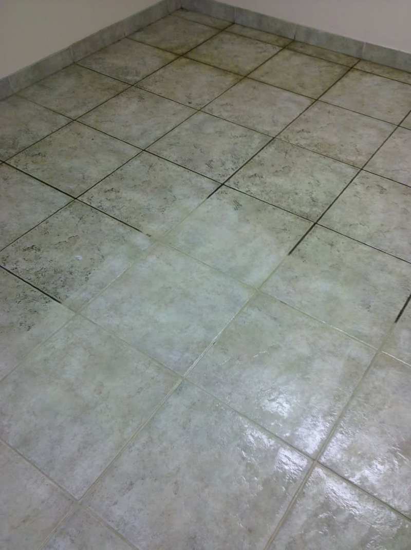

This is a vets office that David and I cleaned. They called in hopes we could get it clean, after 3 attempts by other companies with no avail. Thanks to some ideas from Mikeys Board we got it done and they were happy as could be.
Fort Worth , Texas
I thought the Floor was going to give me he'll because it had multiple coats of sealer applied To it over ten years but itcleaned up very well.
