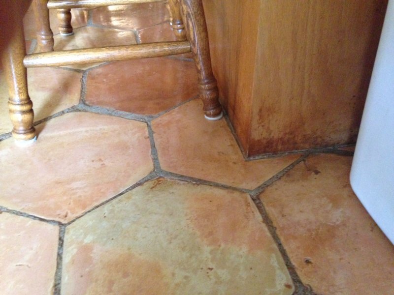

I am doing strictly water and fire construction now and ran across a problem that a contractor screwed up.
From what I understand this has some of the original 30 year old sealer on it and the water base coats on top. The goofball that did this splashed acid all over the cabinets and ruined them. Then they sealed it over dirt, mop swirls, leaves and no telling what.
What is the best process to strip it down and seal it with a matte finish?
Also, is there anyone in the Victoria/Houston area that can tackle it? If not I'll have to hire some rookies and coach them up.

Is that stain on the bottom cabinet or did some strip the floor and splash the cabinets?
Jeremy N
936
Oh, it is definitely from someone splashing. Several custom cabinets in several rooms. The customer is pissed. I have to fix it for them.

Looks like they had a topical finish on the tile and someone tried to strip and refinish. The swirl marks is from them trying to strip and the stripper dried before they could get it sucked up.
Attack it as if you would be stripping VCT. Find out what finish they put down. Do not go cheap on the stripper you will regret it.

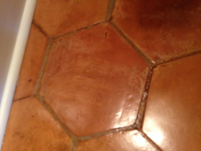

Looks like they put it down pretty thick in pic two!

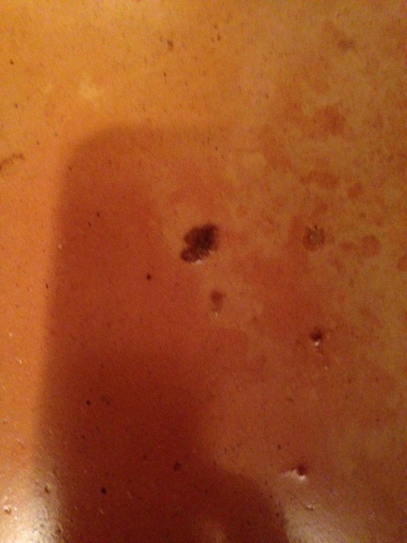

Those chunks are gummed up mess and globs of the old stuff that they didn't clean up before putting down the sealer. It is a mixture of stripper and gunk from when they tried to get the original coats off. Being the thorough guys they are they left it and sealed over it. I found where they went over some grass and a few leaves with sealer. Real fine individuals.

Jeremy that is a nightmare of a job, that would take a skilled master floor tech a week or so to "fix" which is why you have this mess in the first place because they didn't strip the floor 5 or six times to get all the finish off before reapplying new finish.
You need to be careful as if you strip too much also the tile will turn to mud. Looks like man made Mexican tiles to me.
