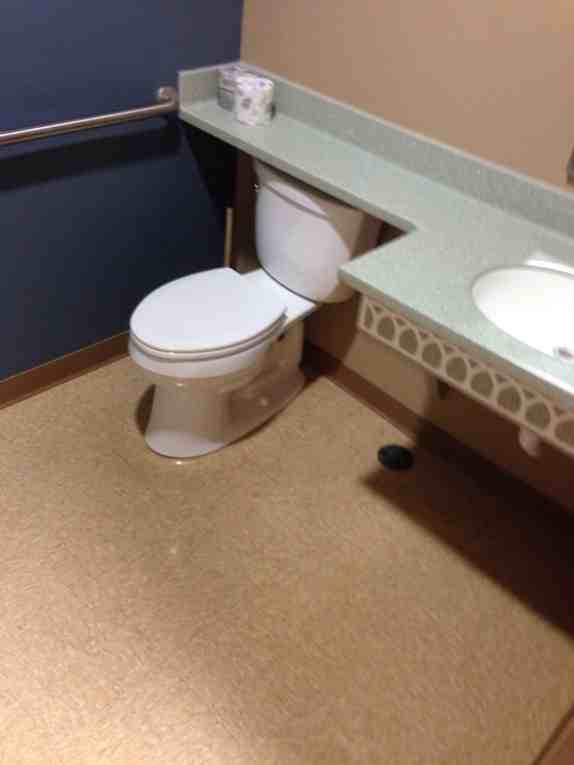

A couple tiny bathrooms that look pretty good as it is. What would you do? Thanks!

It went well guys. My phone died or I would have taken more pictures. There were 10 different areas that needed attention. The VCT went well. I did as Shane suggested in scrubbing it with a black pad under my 175. I just used a neutral cleaner and that seemed to take off enough wax to prep it for 4 coats in the kitchen area, less elsewhere.
The tile and grout turned out awesome too. I used some Viper Venom in my mop bucket with hot water, slopped it on there, agitated with the black pad (175), sucked up the mess with my shop vac. There were small pits in the tile that were black from it collecting dirt. I was able to restore it completely and make it look new again.
I arrived at 5:30 PM and finished by 3:30 AM. I never turned my Truckmount on and feel I gained valuable experience. A little better than $100 / hr is pretty good for this type of work, I think.
