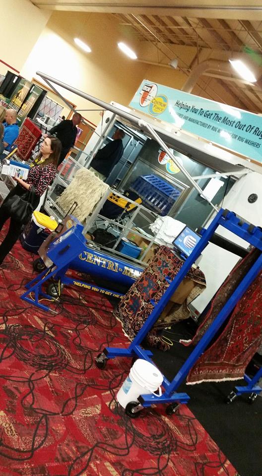

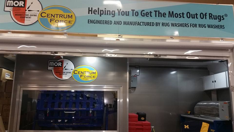

Here is an alternative: Buy our Show Trailer and impress them in the driveway.
The plant on wheels is being offered complete with duster, wash tub, rug hanging system and small centrifuge. The big gas powered generator powers the whole thing. (It even has a killer sound system and P.A. system!) $95K takes all.
