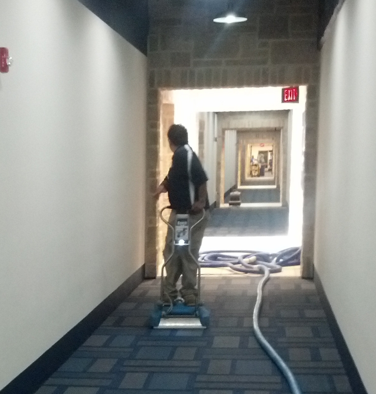

I just the @rhyde lean method to get most of the water out of non-bleeders then Zipper it to extract.... I'd want a centrifuge spinner as a next step.... Time is something I don't have much of....:dejection:

I seen his setup, looks nice... I also looked into RugTech equipment offerings.... I'd need to know the pro's/con's of both wringers before I decide.... Maintenance is a big thing for me as I need to do it myself because were out in BumF*ckEgypt...........

I've done a few small top-down drying jobs.. I've used the water claw followed by the zipper... The wicking of the walls weren't that bad considering the source of the leak was a downspout over flowed between the walls... The wettest part of the wall was cut out to find the source... I used a airpath and dehu to do top-down drying... The carpet/pad dried in 1 day, the other walls took 2-3 days to dry then had a repeat flood as it stormed hard.... The second time wasn't too bad but additional days to dry out was required... It was a ground floor with concrete subfloor...
I get that it depends on the subfloor and pad if your able to do top-down drying.... IMO I think its more possible/efficient with the sub-surface extraction tools available...
