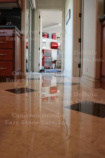

Here are some photos from the job.
During
Done
Tricky, polishing 2 completely different stones in the same floor. The process for finishing each stone would normally ruin the finish of the other
During
Done
