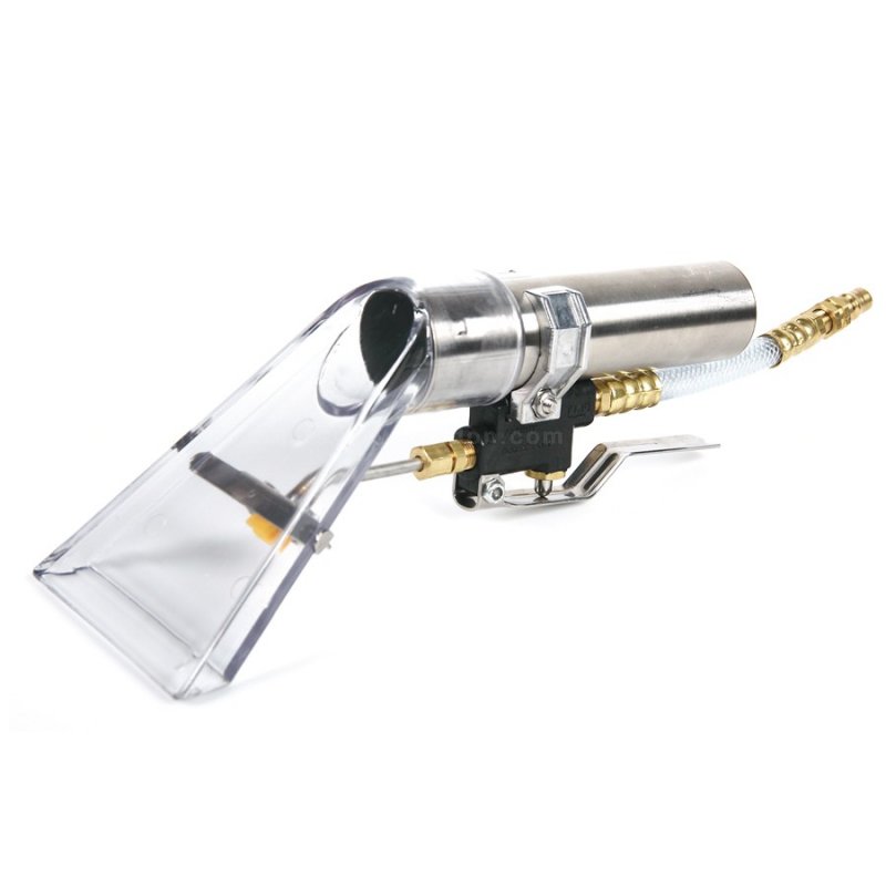

PMF clear head internal jet tool. Put a $30 needle valve from dultmeiers and you will have a $500 tool for only around $150

PMF clear head internal jet tool and put on a needle valve and you will have a $150 tool that rivals those overpriced $500 tools.
www.dultmeier.com
GE 3000-4SS Globe 1/4 x 1/4 stainless $30.01

I actually don't see anyhthing wrong with that clear tooland it should work, especially if you change the valve and the hose(looks like it will pop if pressure spikes)
It works ok with a portable if you have low use. Nice and light weight. The head eventually comes unglued. The aluminium valve and jet will need replacement periodically with use. I would buy two and toss it as it goes bad. Why ook with it.
