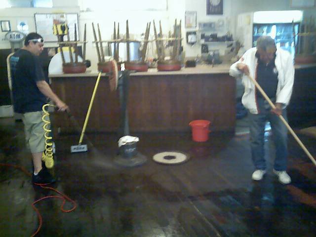

Got a real greasy breakfast joint to clean the wood floors at today.
Lots of mop residue and bacon juice. Wood is severely stained and "worked"..
How about some 02 and a glug of Purple followed by a red pad and a rinse?

I wouldn't put O2 on it. I don't think D-Limonene would be a good choice at all.

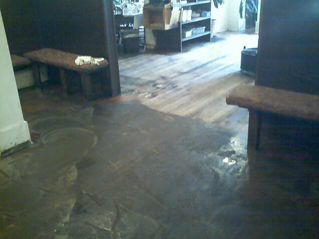

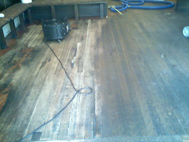

What was a 70 year old beat to death, filthy, muddy, grungy disgusting shit pile of a Doug Fir floor that had not been more than mopped in the last 24 years is now a clean beat to death, disgusting shit pile of a Doug Fir floor..

You know Larry I don't have a "real" good answer. :) Looking at that floor I don't think it would have any negativ effect as it is already trashed but if the floor had any coating left on it I would worry about the D-Limonene turning it to goo..

When you were done,I would have gotten some screens for that 175,then put a couple of coats on it,violla,good for another 50 years. :lol:
