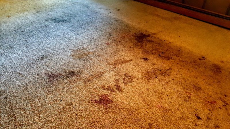

    This job yesterday was the most extreme food dye job I've seen in 30 years. I'm sure many of you have seen worse, but I've never been an apartment hack per say..
    Just after pre vacuuming..

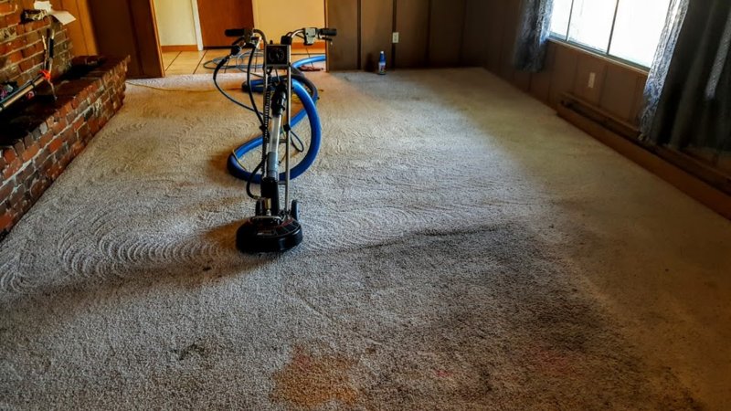

    Half way through

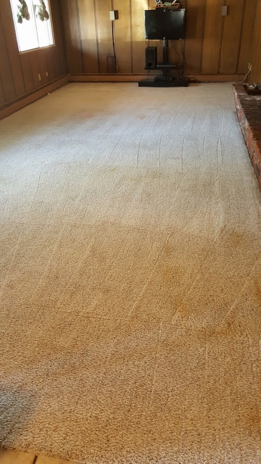

    Finished

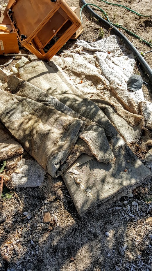

    Found on the side of the house/rental. Maybe I should go back and grab a few yards for testing..

      Better off using the crb and boosting the prespray.
      I still like stain magic where I see color left. Spray and leave it.
      If you used prozyme plus and scrubbed that carpet in the picture after it was cleaned all those spots left would ball up and be left on the surface for easy removal.
      Do it before make sure you clean your filter because even after vaccing you will get so much soil it will plug it up halfway through.

      Better off using the crb and boosting the prespray. Better off than using a 36oi Brush Head, you're on drugs..
      I still like stain magic where I see color left. Spray and leave it. Stain Magic on Synthetic dye?, you're on drugs..
      If you used prozyme plus and scrubbed that carpet in the picture after it was cleaned all those spots left would ball up and be left on the surface for easy removal. Ball up? what? You're on drugs..
      Do it before make sure you clean your filter because even after vaccing you will get so much soil it will plug it up halfway through. Dry soil was not the issue here...good lord you sure get the good dope there Steve.

      I guarantee that upper left corner would look better with the crb. Those shadows are oils and solids I believe. I see it all the time. They come out in a coagulated ball full of fiber sand and goop.
