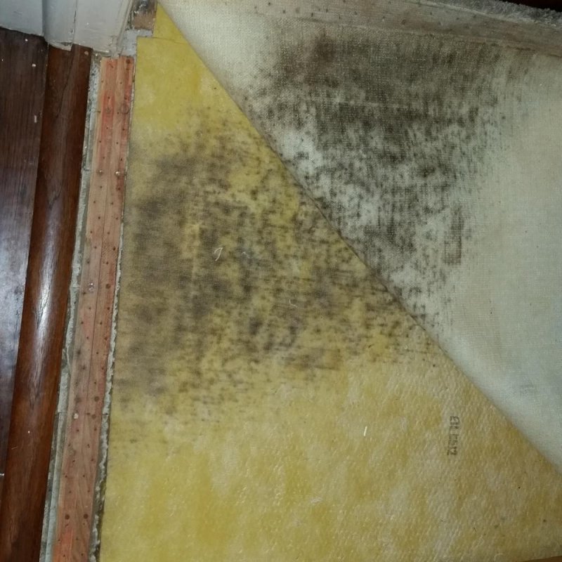

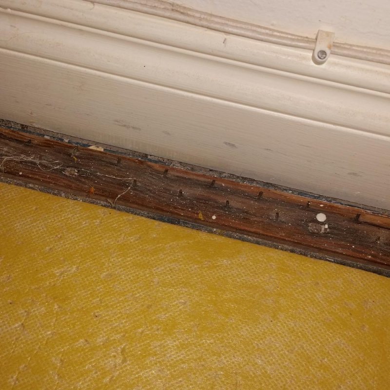

We have a customer that claims we overwet their carpet and this was the result. These pictures were taken 4 days after the cleaning. I won't say anything more, I just want your opinion on whether this could happen in 4 days?

No way. The tack strip next to the wall has been rusting for awhile...sharp points have disintegrated.

I've always heard if carpet is wet for over three days mold can happen. The thing that looks off to me is there is no rust on the tac strip or carpet backing, and the wood does not show any signs of rot. That is quite a bit of mold for 4 days, but in a humid climate, I guess it could happen. Man, this is a tough one for you. Was that the only spot with mold? If so localize it and treat it, then get some air movers down and dry that puppy out. If not localized, then you're dealing with the spreading the spores. Ugh, Good luck!

How did the customer know what was going on under that carpet? Any reason for that area to have become wet for any reason in the past besides carpet cleaning? What is true condition of tack strip? Can't really tell.

What was the moisture content of the subfloor when you got there ? I'm almost certain that was pre existing. If by chance he did some subsurface spotting in that exact spot...maybe. But I would look at the closet or rooms nearby. Is a water heater close? Is the tack strip in similar condition in the entire room? If it all looks like it got soaked, then it definitely wasn't from the cleaning. Without any drying equipment, the amount of water it would take to soak carpet padding and tack strip would not be totally dry 4 days later. If if is totally dry when you showed up I'd guess it was a prexisting flood that wasn't handled properly. Definitely wouldn't treat it with anything. It all needs to come out. But not necessarily on your dime.

Yes. Mold can become visible that fast.
Right in the threshold where it would be the dirtiest and likely overworked.
Doesn't seem to extend beyond that.

Pre-existing condition. There was moisture on that tack strip previously.
It is possible that moisture from carpet cleaning exacerbated the pre-existing condition, but that did not start from carpet cleaning 4 days ago.
The rot in the wood, the amount of rust on the nails in the tack strip, those took a while to develop.

We did the cleaning in June of 2015 and are just now being sued for the damages. The pictures are of separate bedrooms. The carpet was installed on a concrete slab. Although we still consider him a newer employee, the guy who did the cleaning has been with us since 2004. He even went back 3 days after the initial cleaning because the customer alleged that it was still wet. The cleaner did not feel it was wet but dry stroked both rooms again just to appease the customer. I went out 4 days after the cleaning and found the mold, took the pictures and explained to the customer that we couldn't have been responsible for the damage since it was apparent that it was a pre-existing condition. I have been in this industry for 35 years and I can tell you there is NO way that amount of mold happened in 4 days, especially not from a carpet cleaning.
The picture showing the rusted tackless was just below a casement style window that needs to be pushed from outside to get it to fully close. That was the only area of the carpet that exhibited anything even close to that.
The second picture was a spare bedroom being used as an office. What you see is the entrance to the bedroom off a wood floor hallway.
Oh and they had a very, very old golden retriever who had to wear a diaper because he "leaked" and the dog was so feeble that they had a harness with a handle on it so they could help him stand and walk. The dog spent most of it's day laying on the carpet in the office.
Once we discovered the mold we relaid the carpet, closed the doors to the bedrooms and installed a dehumidifier in the hallway so as not to distribute the mold spores.
When we picked up the equipment, the owner admitted that it was probably the urine that created the "wet" feel. He knew the dog was the issue and was waiting for him to pass because he couldn't bring himself to having the dog put down.
