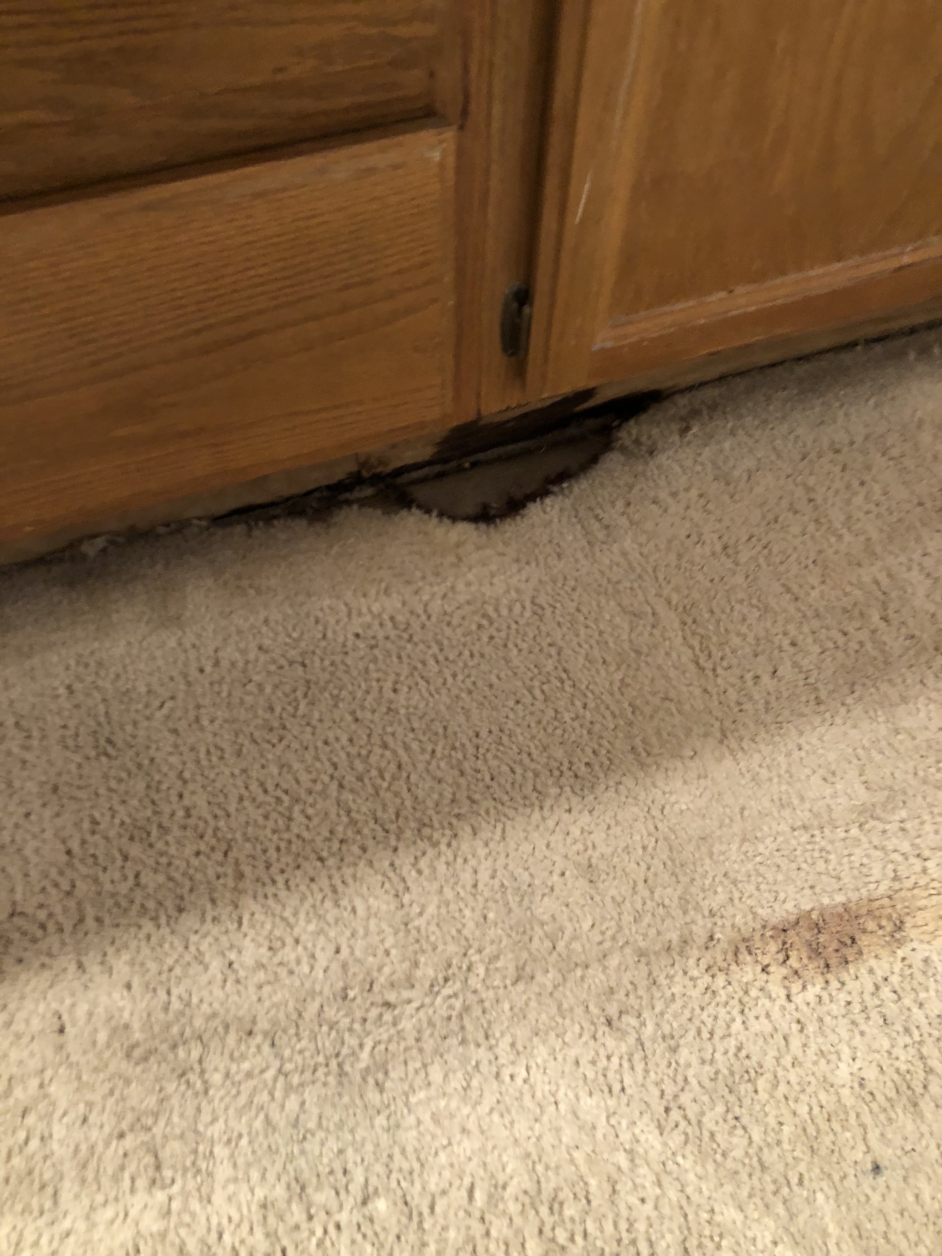

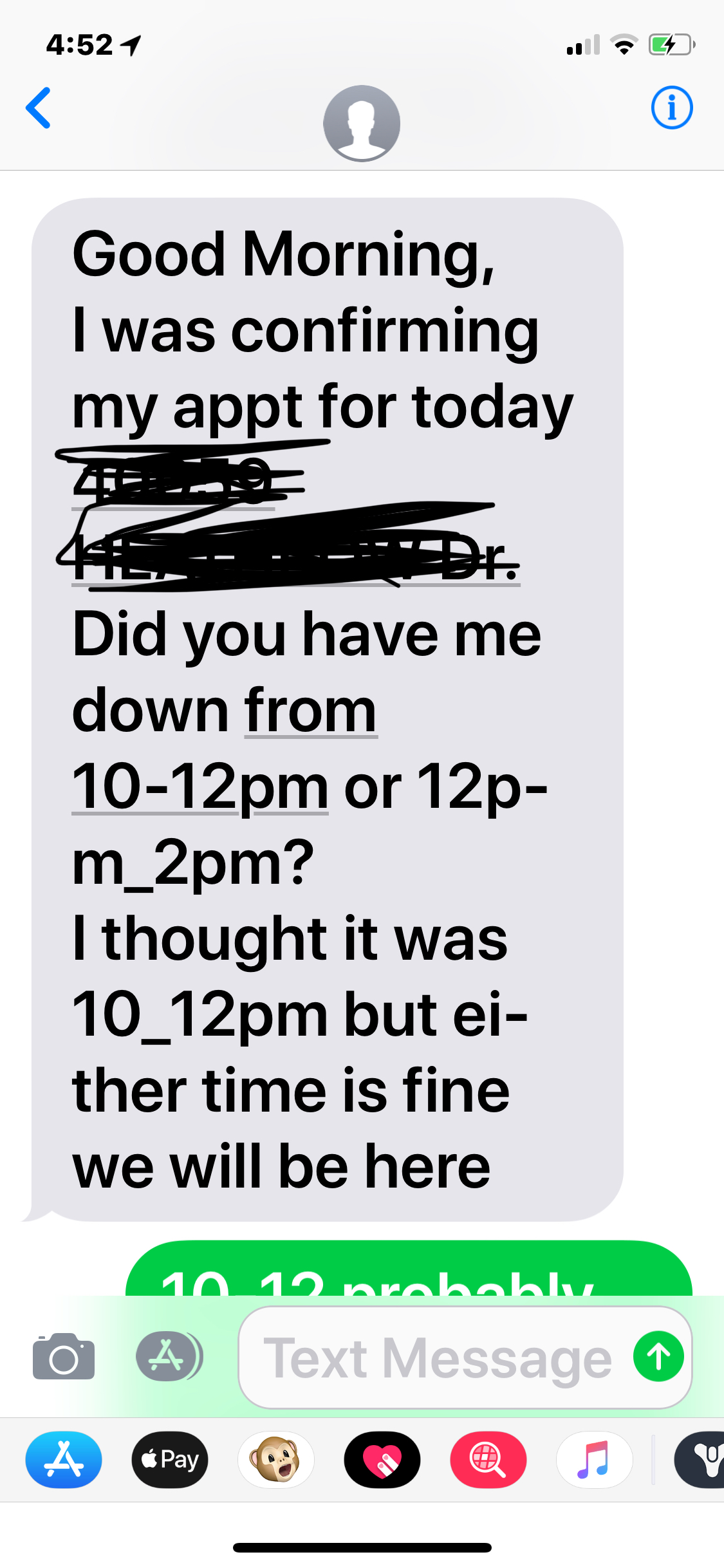

    BBBCE670-80CC-42F3-9640-EA065A36FED2.jpeg 8DC246BD-597E-45F3-BD1B-4705428B1A3B.jpeg
    This was her text that morning before the machine broke down took me an hour with two trucks to zip her crap hole today!
    I’ll never go back!
    The husband is a peckerhead and knows the carpet needs replacing!
    I told her ya it needs replacing and won’t hold up to another cleaning.
    But I got my review changed and I was pleasant!
    Dudes a mechanic I showed him what went wrong!
    They took their free cleaning!
    They drive a Mercedes and have 1985 televisions and ps2
    Everything about the House screams slum!
