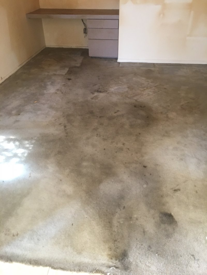

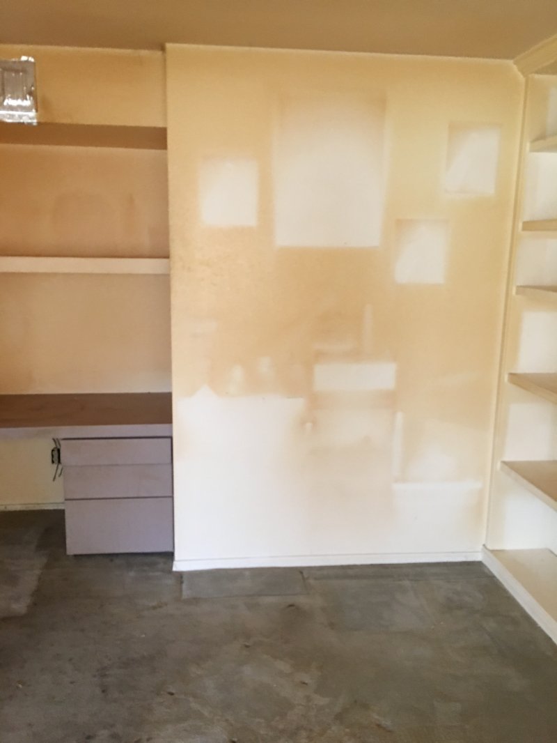

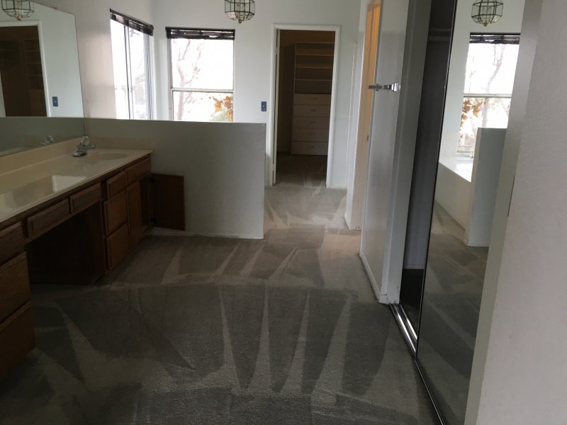

Cigarette smoker destroys room
11,094

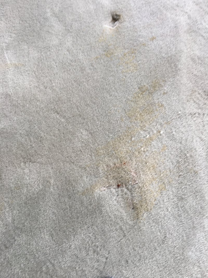

What did you use to get out the ash tray damage?

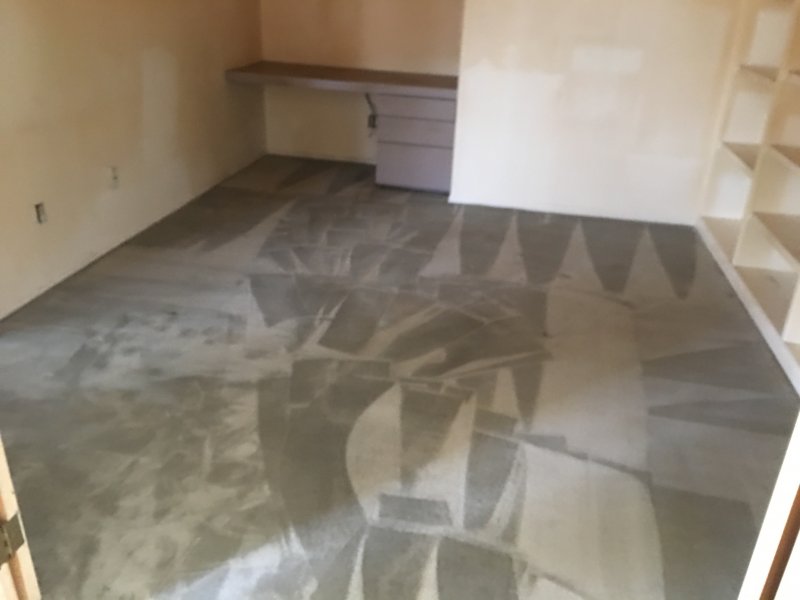

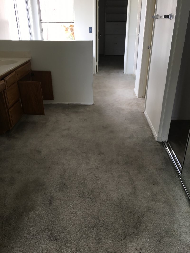

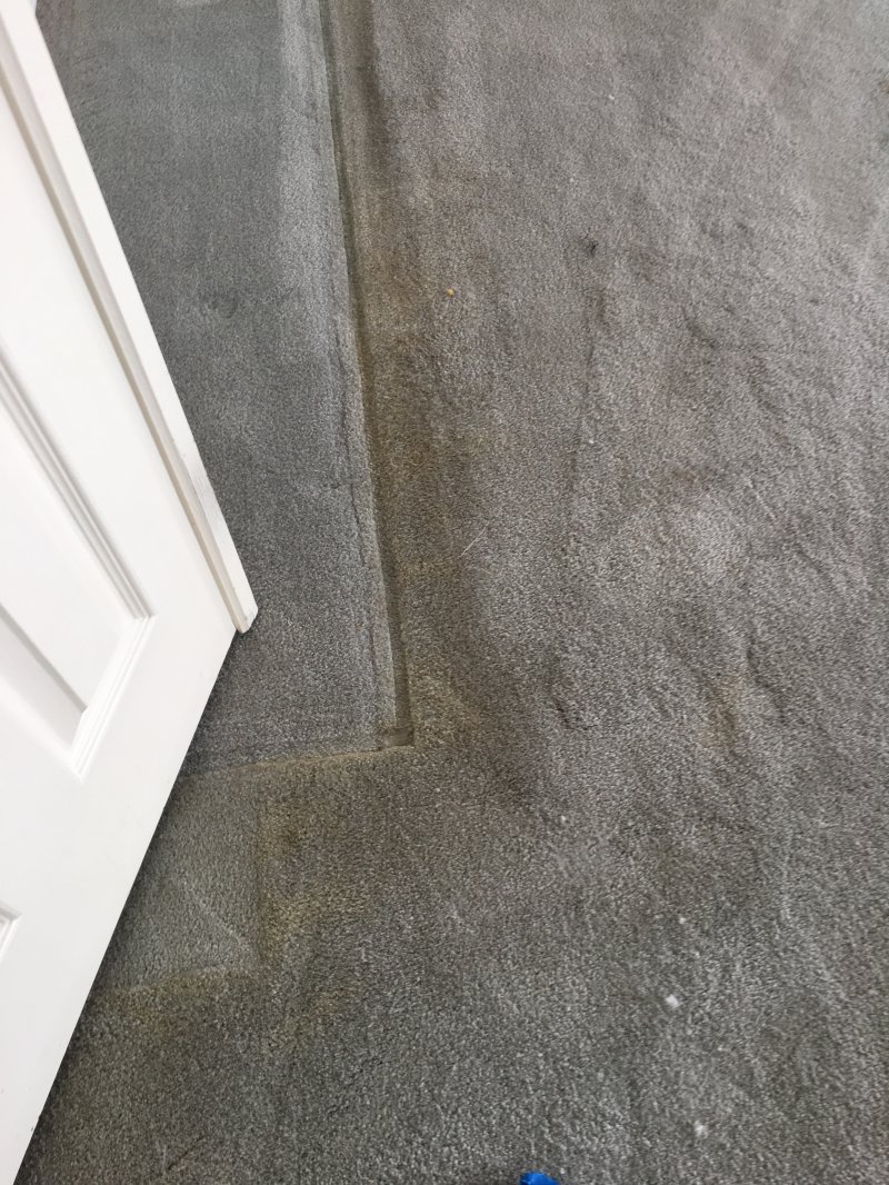

Pre vacuumed with a Shark, pretreated with grease eater and d-cide, scrubbed with crb, my son rinsed it with a Mach 15 wand and a 405 , I retreated a few black spots with a degreaser and fels and rinsed those with my 570 and a 2 jet stair tool.
I had just finished the steps.

Oh yeah, the shark was the main ingredient right?
11,094
And you did all of that for $49.95?
It was 4 bedroom, loft, office, 13 steps hall 2 bath rooms and 2 walkin closets $304.00.
I charged an additional $60 for pet treatment.
$364 minus 10% off $328 out the door. We were there a total of two hours with two trucks.
I had to leave and get gas so I was there an hour and a half. While son pre vacuumed the house.
I set up both trucks we used two hydroforces to pre spray. Jeremy CRB'd everything and we split the cleaning.
