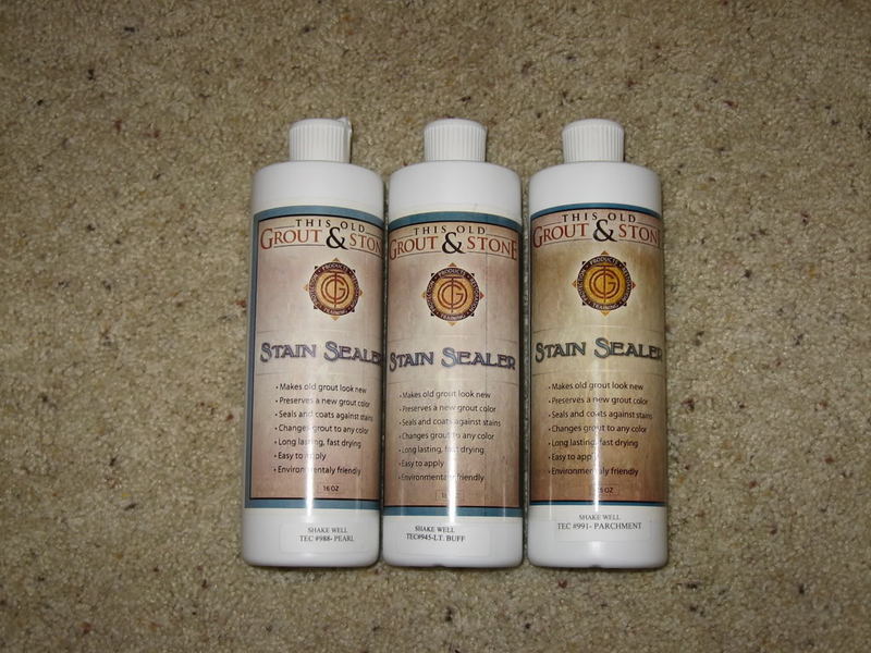

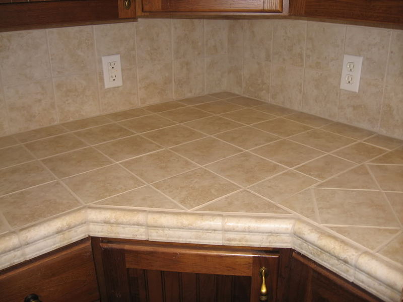

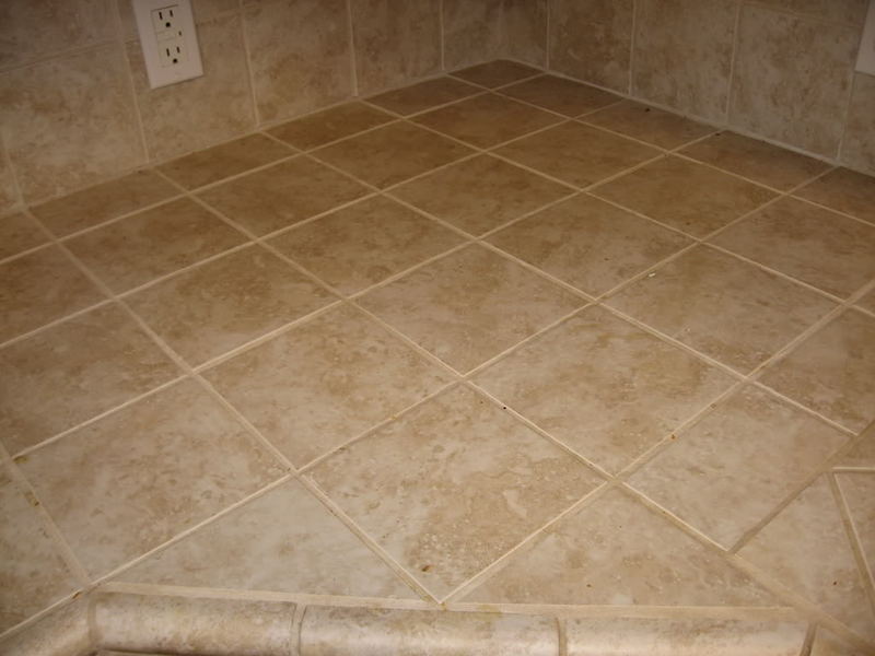

Got my color sealer in today.....tomorrow I'm going to try to clean and color seal my countertop and backsplash. More pictures will follow....I'm pretty excited to see how it turns out as my countertops are in need. I've also got my in-laws floor to do and grandmother in-laws floor to do so that's why I got 3 different colors....I should have it down by the time I'm done and be ready for business!!! Our counter top is going to be pearl....

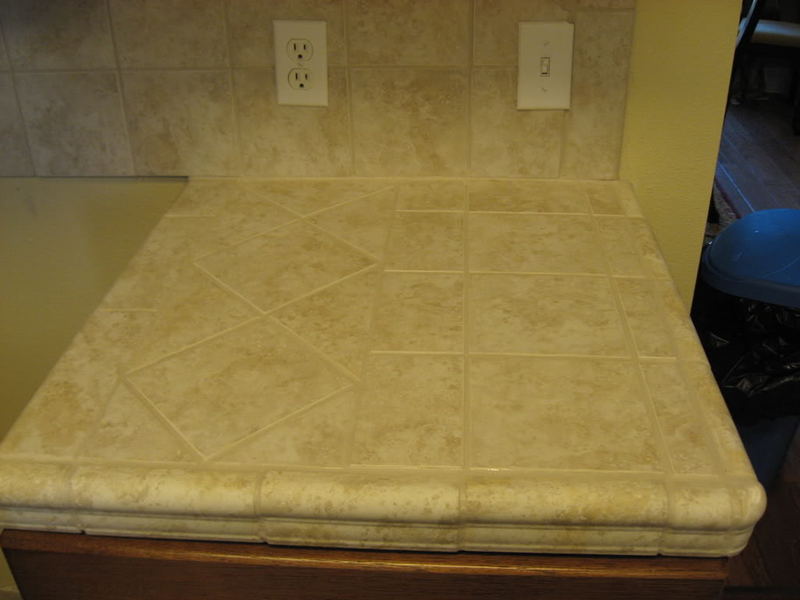

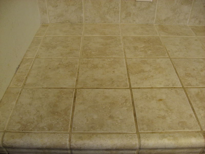

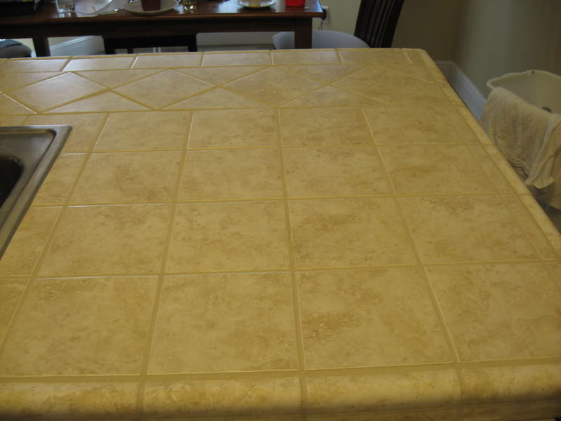

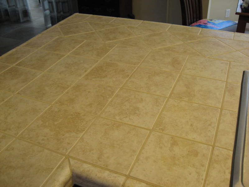

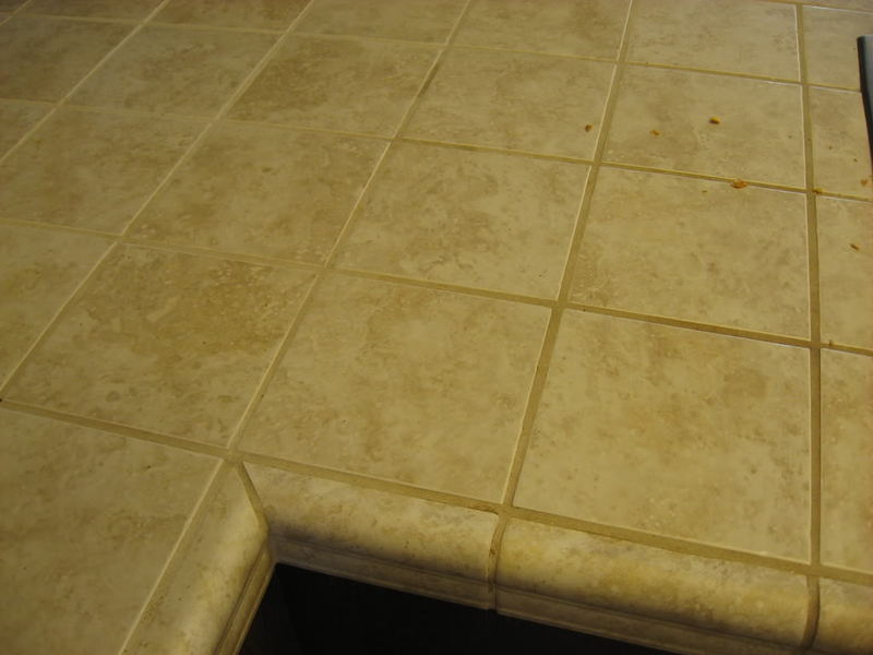

Before and afters of the cleaning.....I'm waiting for it to dry good before I get going on the sealing. And yes I know it's filthy before but we are busy and don't have time to keep a spotless house all week long.
Normally I would use acid and have better results but I'm color sealing so I just alkaline scrubbed and rinsed.....
Before
After
Before
After
Before
After
Before
After

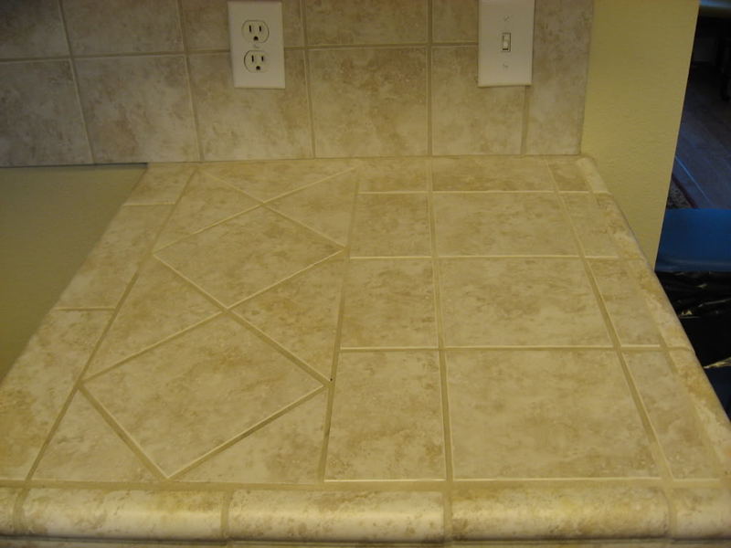

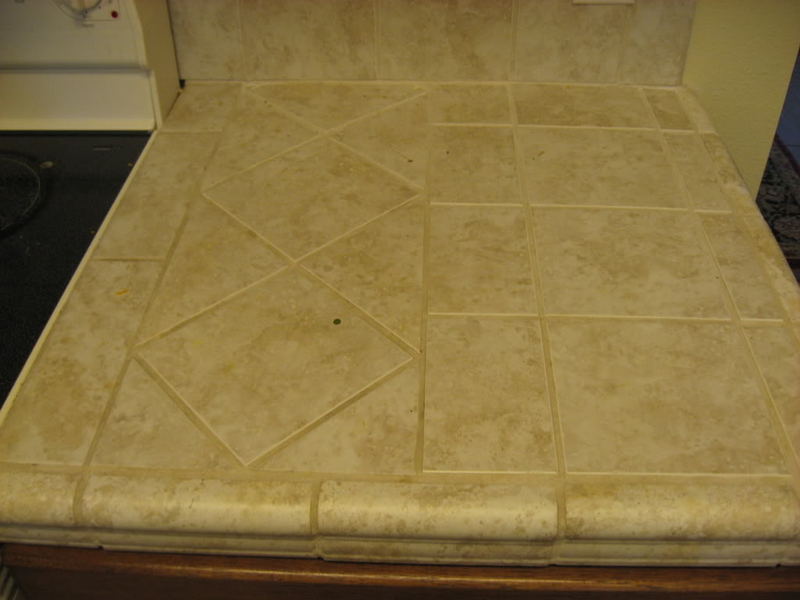

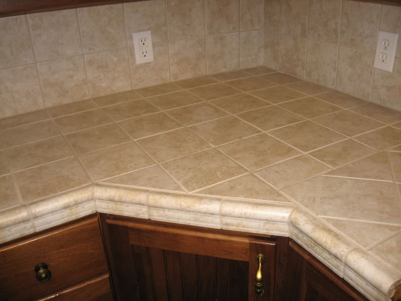

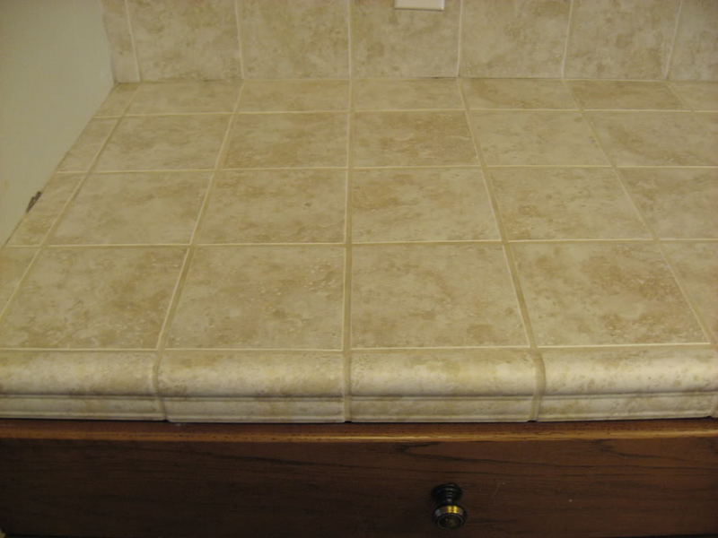

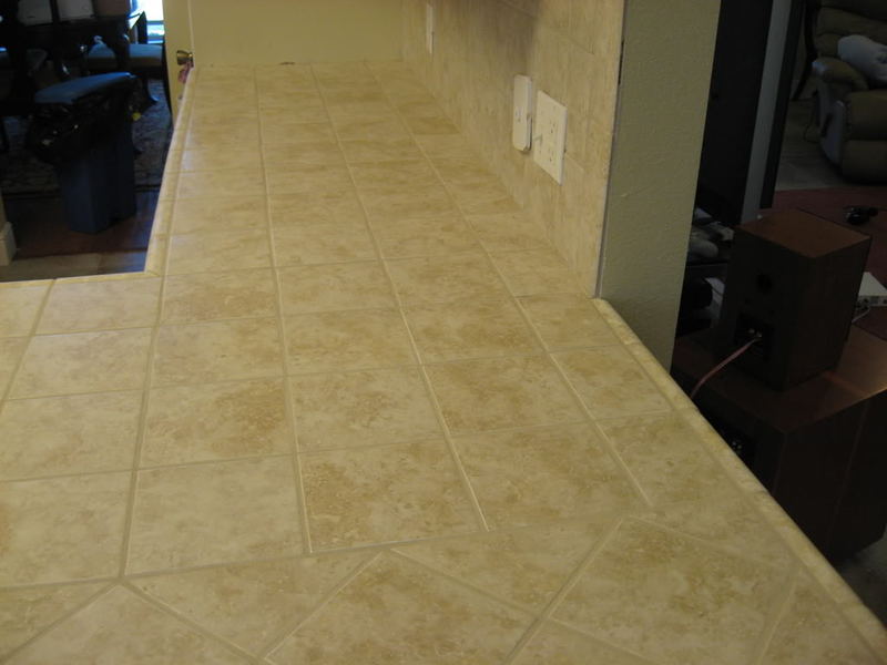

Mission completion for sure.....check it out. Not too hard to do for sure. I think it looks good for my first time....
TimP
May 19, 2007
4,055
Never color sealed before. I've grouted and layed tile though. In fact me and my wife layed the tile there. Of course it's not perfect. There is some color seal on the tile but you can barely even see it now cause it's so close to the tile color. But most of it is pretty clean.
One tip I have.....get a toothbrush without the blue indicator for replacement. Two times blue dye or something bled while scrubbing and I had to wipe it off. Second don't be affraid to do a good bit ahead of you. I think it will be easier with bigger tiles on the floor and I'm planning to do some 13" tiles next week on some days off.
All I can say this stuff isn't hard at all....you can't hardly screw it up and it looks awesome....even better than the pics in person to me. The only thing you could screw up is getting sealer on the tile. And if you have to it scrapes off....I would say it's the equivilent of paint. It smells looks and acts like paint to me. It may be harder on a rough tile....this tile is completly slick so it may make it easier to fix. Like I said I have some floor tile that's more rough to try and see if it's harder. Right now I'm more concerned with longevity of the product before I go out and start selling it. The product says wait 7 days before you get it wet and start cleaning.
