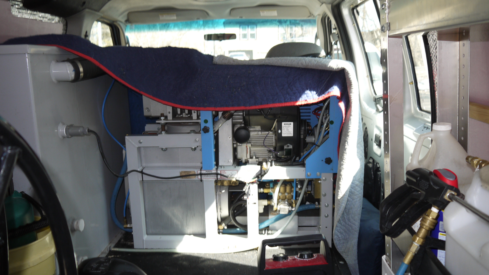

Your trying to make a cave/tent of heat. First blanket - over top and drivers side of tm covered.

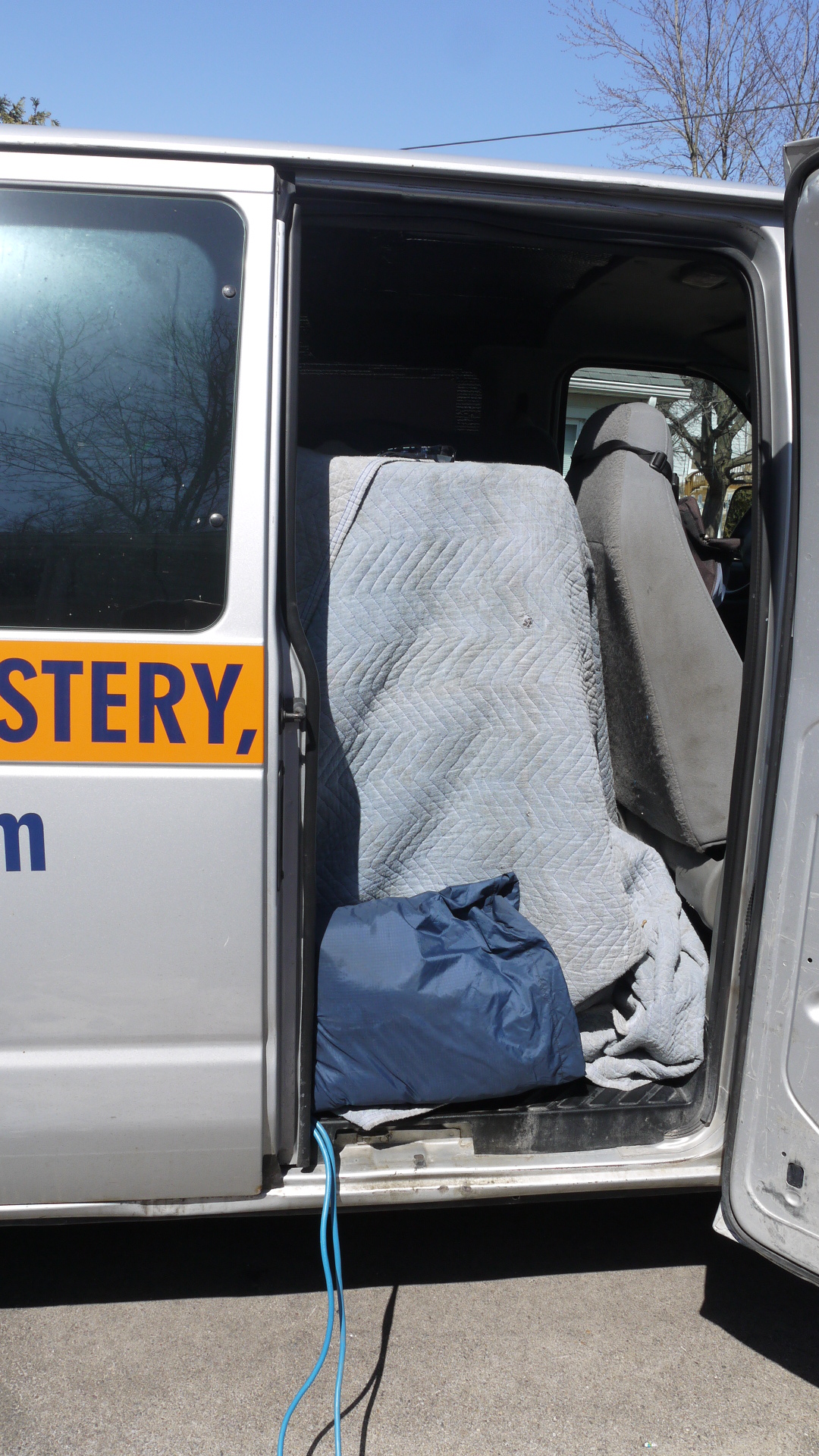

Second blanket - Over front of unit and driver side, leave the cave "open" and extra blanket at bottom. Van doors are the coldest place in the whole van.
Take your door guard or blankets, towels, whatever and stuff it at the bottom of doors(coldest area!). Before this step, throw you two extension cords(for heaters) in the van. After the side is sealed up with door guard and blankets it will be tuff to get cords in.
Just doing this above, you generally be good with one heater on low down to... Heck, 20 degrees at least... Put your remote t- stat on top, good to go.
You want your "tent" to look like this. Two heaters at bottom of photo, both plugged in ready to go. Exit through back of van!
The heater on the left(150$) is digital. Push a button to whatever temp you like and the unit will keep it there or try to at least. Second heater(right) no t-stat, it stays on. Front of machine will freeze first! Plug one heater in at front of house - one heater in back of house. Different circuits.

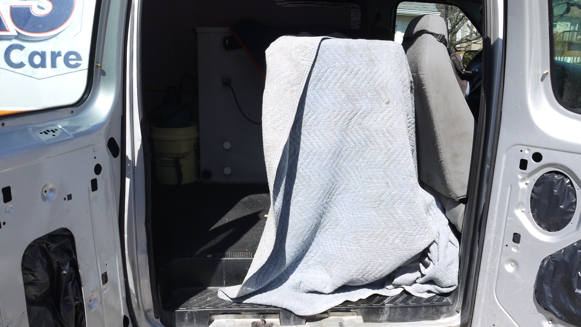

Take another blanket and drape it over tm and somehow attach to van wall or shelf. This again is going to help guard the door area. Stuff that shat in to the step in area.
Another photo of door area...

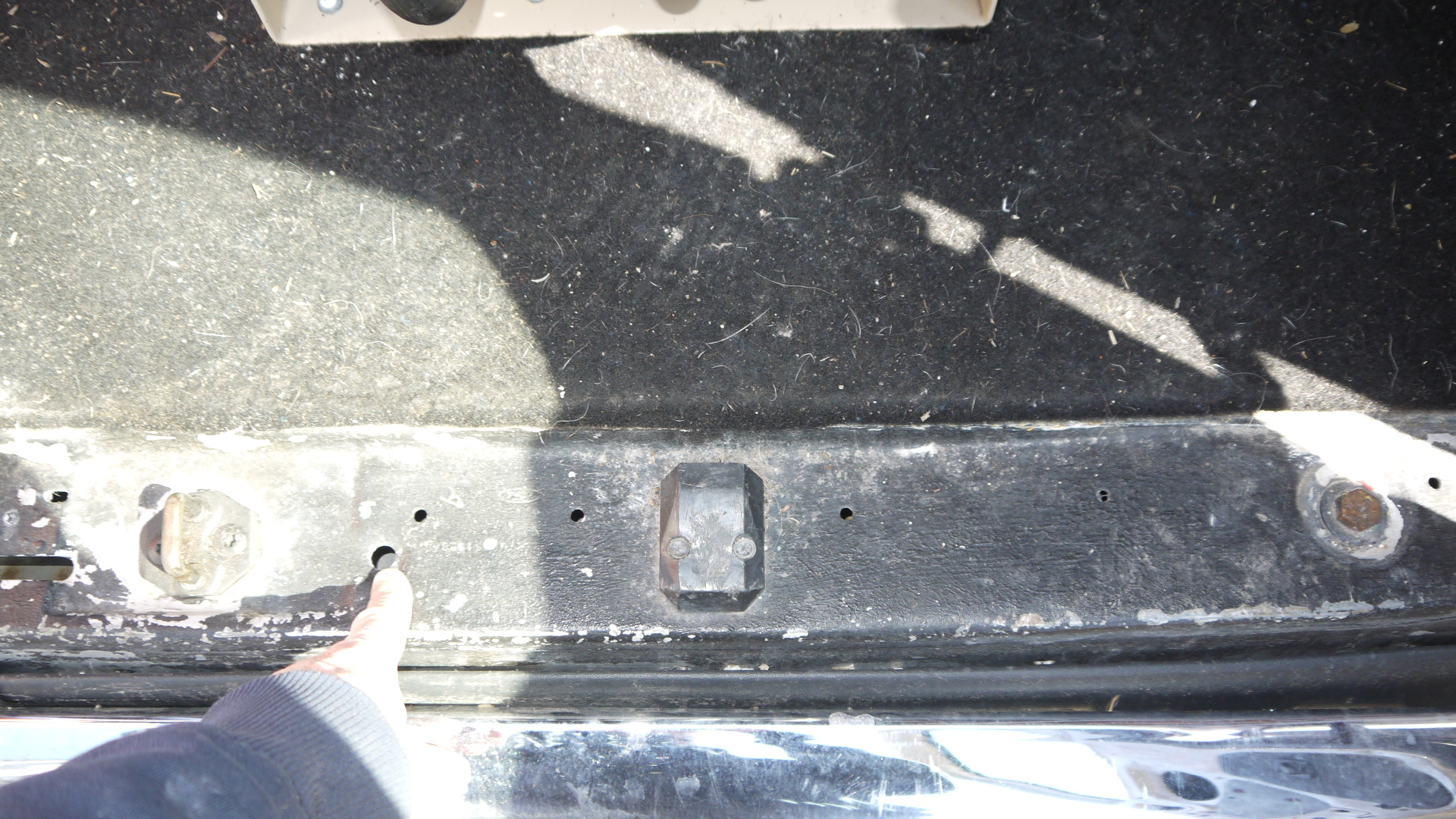

Back view of van, bottom of doors coldest area, stuff some blanket or towels down there.
My stupid van has a bunch of little holes like this all letting in cold air. That's what the blankets might help with.
